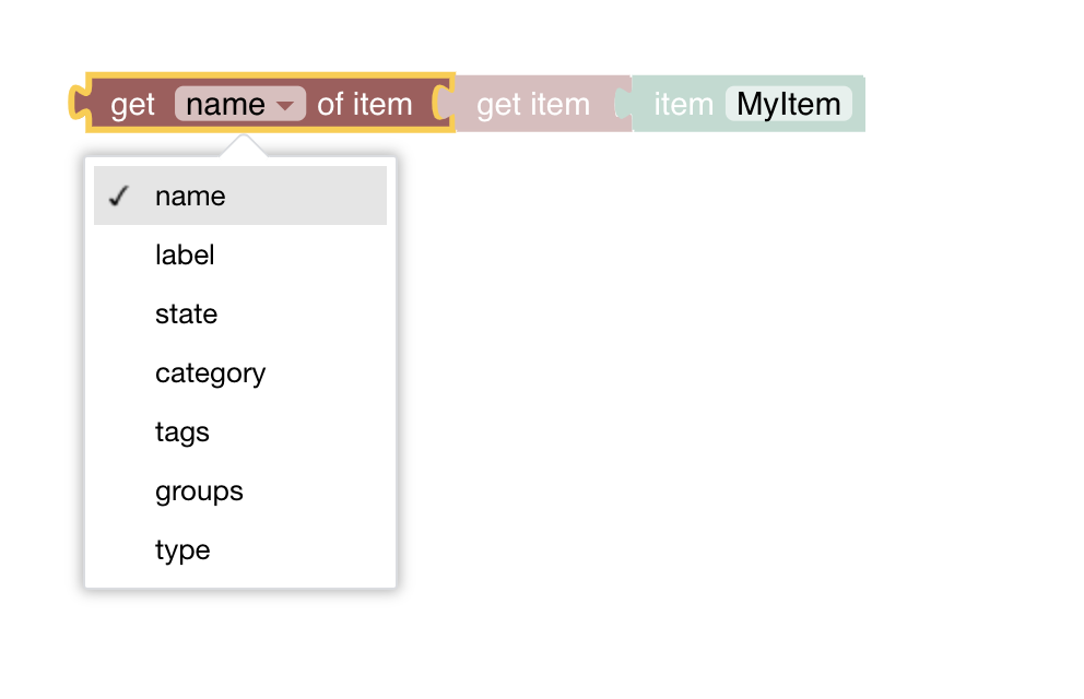

  • What’s the point of the ‘get item’ block, where’s the difference to the ‘item’ block?
    • the item block is only a wrapper for an item name which is actually used by the get item, which returns the whole item which can be used as follows
  • Why is ‘get state of item’ a separate block, given one can also get the state with the ‘get item name’ block (which may be better named as ‘get item property’)?
    • this was already available and we cannot remove it. The one I depicted above was added later by me and is more generic
