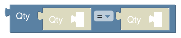

You might be using the wrong block for the comparisons. It’s hard to be certain without a screen shot of the Blockly blocks or the full rule (i.e. full contents of the Code tab).
You are using the block from “Logic”.
You need to use the block from “Units of Measurement”.
You’re absolutely right, thanks a lot!
