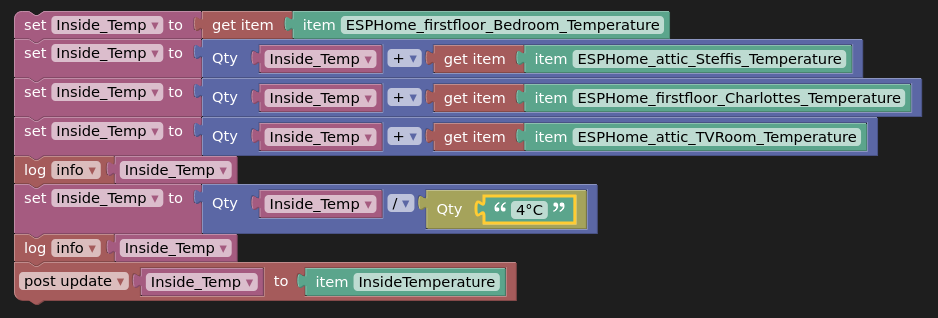

Here is the blockly script:
and the code:
var Inside_Temp;
Inside_Temp = items.getItem('ESPHome_firstfloor_Bedroom_Temperature');
Inside_Temp = (Quantity(Inside_Temp).add(Quantity(items.getItem('ESPHome_attic_Steffis_Temperature'))));
Inside_Temp = (Quantity(Inside_Temp).add(Quantity(items.getItem('ESPHome_firstfloor_Charlottes_Temperature'))));
Inside_Temp = (Quantity(Inside_Temp).add(Quantity(items.getItem('ESPHome_attic_TVRoom_Temperature'))));
console.info(Inside_Temp);
Inside_Temp = (Quantity(Inside_Temp).divide(Quantity('4°C')));
items.getItem('InsideTemperature').postUpdate(Inside_Temp);
For example, if the sum of the four temperatures is 114.6°C, dividing by 4°C to calculate the arithmetic mean temperature of the four sensors gives 1.39906187984845751398159841241205134450, a dimensionless number (I guess when dividing °C/°C, the unit cancels out). However, when in the next line updating the item InsideTemperature with the variable Inside_Temp, the unit °C gets appended and the state of the item becomes 1.39906187984845751398159841241205134450 °C.

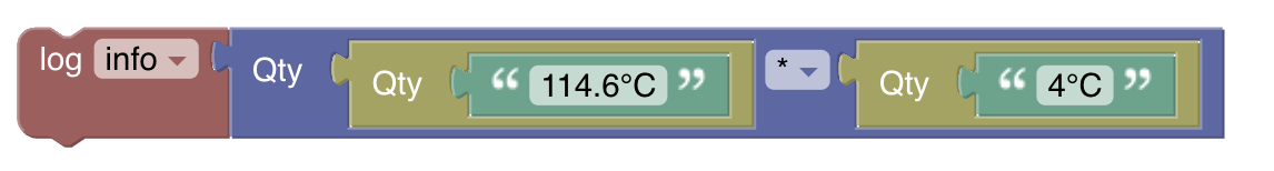

Multiplying 114.6°C by 4°C gives 107464.9125 K² and the following error message:
14:19:31.298 [WARN ] [openhab.core.library.items.NumberItem] - Failed to update item 'InsideTemperature' because '107464.9125 K²' could not be converted to the item unit '°C'

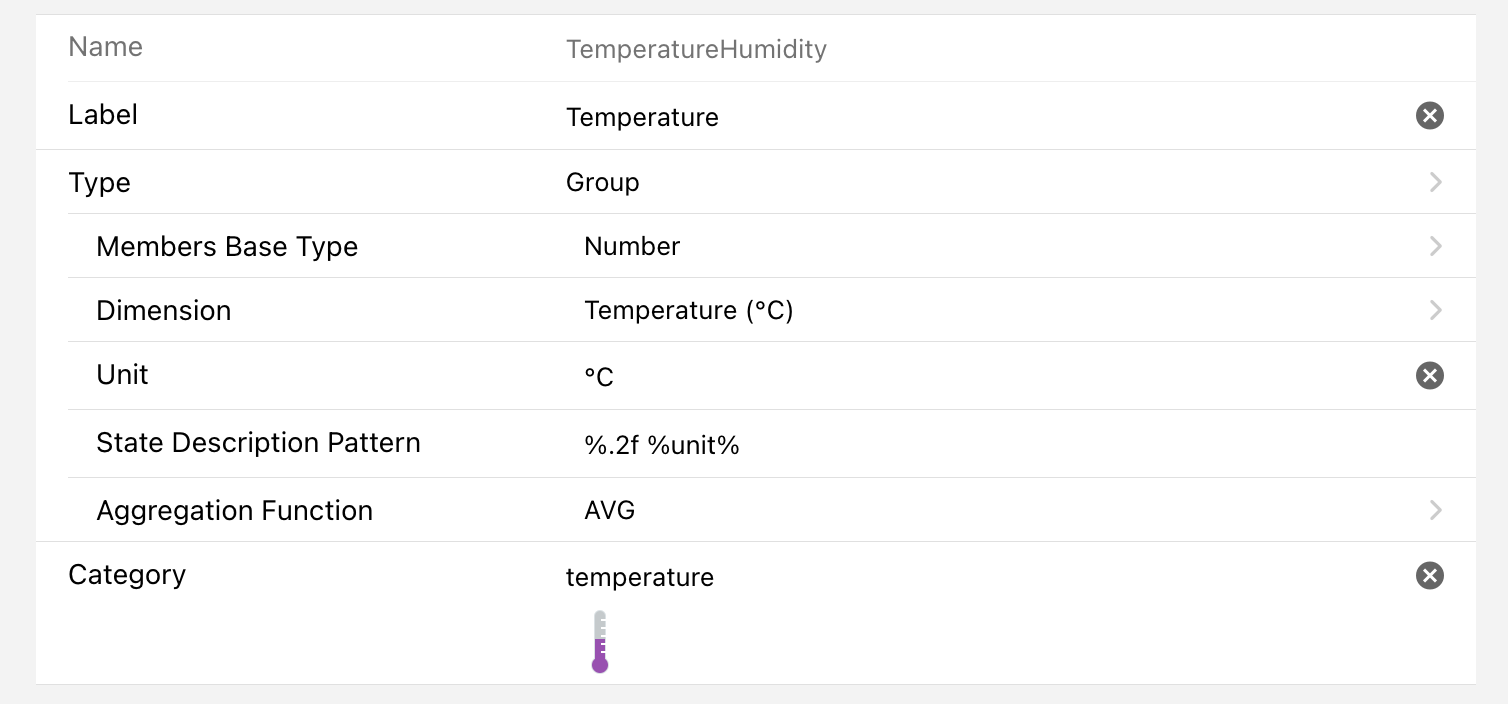

or you work with a group
intForumUoM2
The group can also form the mean with Aggregation_Function = AVG

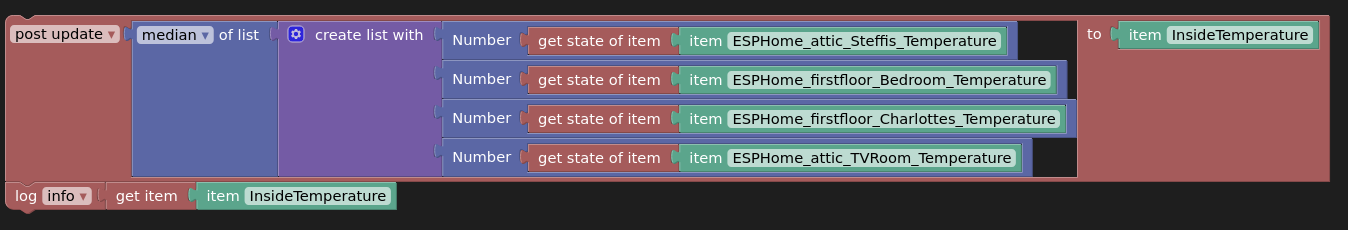

thanks for providing a solution to the issue. For future reference, I’ve updated the blockly script to this:
Now instead of calculating the average by summing the individual sensor values and dividing by the number of sensors, I use create list with block and the median of list function as shown in your example.
However, it is still a bit cumbersome to convert the item state into a pure number first, then do the median calculation and finally appending the unit again during the post update to InsideTemperature item. I thought the math calculation blocks are now able to handle the value plus the unit directly without stripping off the unit. Rules Blockly - openHAB Extensions to the Standard | openHAB
Anyway, the script is much cleaner now and works.

indeed becomes 107464.9125 K² because scientifically it is the correct way. Celsius must be only multiplied by a scalar. I am not sure why you want to multiply the temperature by another one but if you do, scientifically it must be converted to Kelvin first which then results into Kelvin (squared) of course, which then cannot be applied to the state of course.

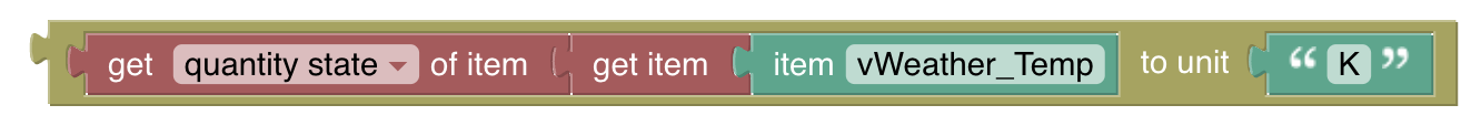

Beyond everything that’s been said I just want to add that there is a ā€œto unitā€ block you can use to convert your Item’s states to K before calculating the average, and then convert the result back to °C using the same block.
@stefan.hoehn and @Mherwege , do we know if the Group AVG aggregation function handles temperatures correctly? I’m not in a place where I can try it easily right now. I’ll try to remember later today if you don’t know off the top of your heads.
@pohl7542 , if it works, you don’t need this rule (or at least this part of the rule). Just put all these Items into a Group:Number:Temperature with an average aggregation function and the state of the Group will be the average of all the members of the Group.

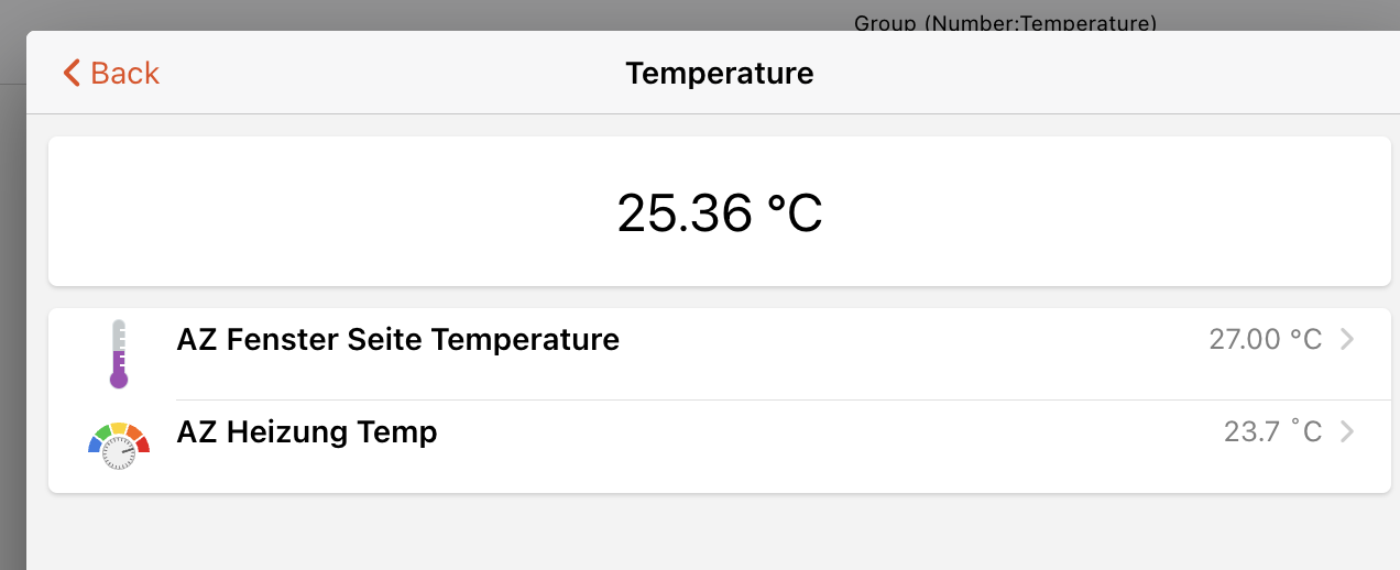

Yes, as far as I can see:

@rlkoshak Using a group with the AVG aggregation function is probably the way forward as I don’t need to create the rule to update the InsideTemperature item anymore.
