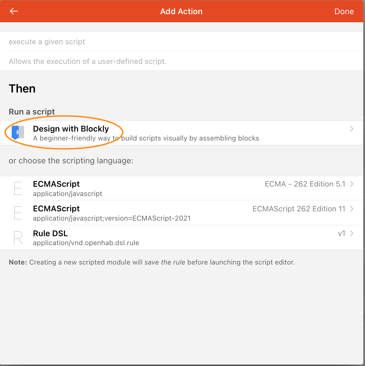

Show us some screen shots of how you create the rule and the script action, step by step so we can see what you are seeing. Note that you must select “Blockly” from the list when you create a script action or script condition.

Create rule (give a name) > Add trigger (choose from items) > Add action >
when I press “Design with Blockly” there appears the script text editor, no Blockly UI.
