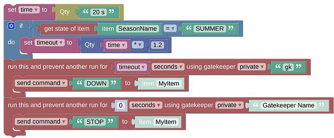

Unfortunately, all my Z-Wave things for rollershutter don’t support sending a position in percent. So I have to do something like send DOWN, wait a few seconds, send STOP. This works okay so far… Now I’m currently improving my rule with a more “dynamic” behaviour: I’m calculating some correction_factor and multiplying the default waiting in seconds with this factor; e.g. default is 20 s and so I get 20 s in winter and 24 s in summer. Now my workaround is to use an “not pretty” if - else if - else if - else to be able to use different wait times.
If we talk about seconds, then definitely use timers.

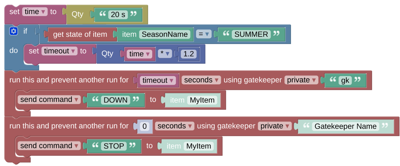

You would probably benefit from using the Gatekeeper block from openHAB Rules Tools [4.1.0.0;5.9.9.9].
You can calculate the amount of time put into a variable and use that to time the gatekeeper.
The gatekeeper will manage the timers for you.
