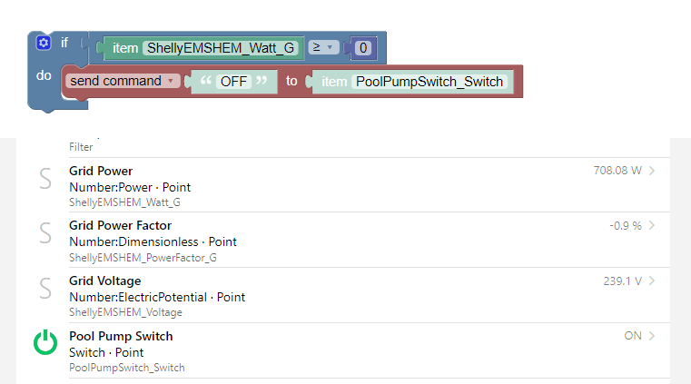

I am an absolute beginner in blocky. I really like the interface, but am struggling to do a basic function
I have tried every condition, >,=,<, etc. The only one that works is ‘not equal’
Any ideas on why this doesn’t work?
I suspect this is because the Item has a unit attached to it.

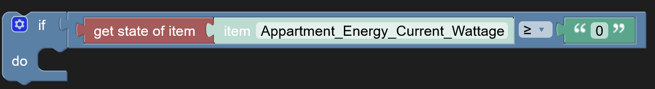

You need to compare the state of the item not the item itself. Try this:
Trouble is, the state of Item comes with units W …
Basically the answer is right about the fact that the value contains units.
You probably fell into the same “trap” like I did quite some time ago where I opened a bug myself: https://github.com/openhab/openhab-webui/issues/836
You can see my answer here and we also had a rather long discussion here:
I hope that helps to understand the background.
Okay so this worked. Thank you very much
