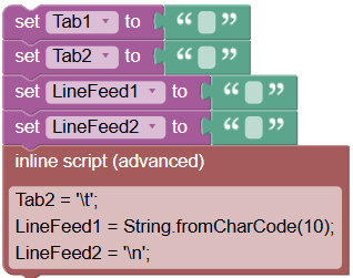

Moin,
I see the InlineScript as a solution.
Tab1 has the special feature here that a tab character has been copied in a text editor and pasted invisibly in the text field.
I only have limited testing options - try to see if it helps you.
“Simple clever” thank you!
