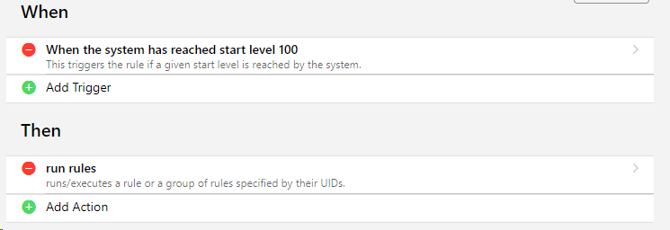

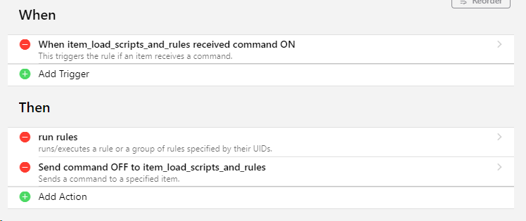

OK, so this is how I did fix this issue.
I did that before @rlkoshak suggested to test the event, so I may revisit the solution to remove the use of the item’s metadata later. Anyway, it works like that:
  1. I created a dedicated item called “Load Scripts and Rules”
=> this item is used to
  • have a button to press to trigger the 1st, “blank”, execution of scripts and rules that have the JS helper library load time issue – when a rule is updated I can either run it or press this button and let it work
  • Trigger that at start time, which is the true resolution action
  • Share information between several scripts/rules using this item’s metadata

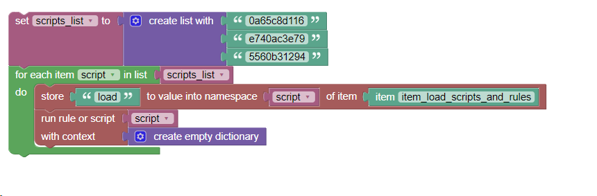

  1. I created a script that is intended to run all scripts and rules “blank” (not actually doing something, but only for the scripts/rules to be executed and have the helper library loaded if needed).
This script is executed by a rule when the previous button receives “ON”
This script is executed by a rule after openhab service has started (level 100)
  1. what’s in this script content:
pretty simple, actually.
a loop on all scripts or rules IDs that need to be executed once at start time. Currently I put only 3 of them (see example below) but I’ll extend to almost all my scripts/rules – all that needs to be executed without the 30s delay.
The idea is to put the string “load” in the special item’s metadata namespace named after the script/rule ID.
It’s the way to share information between this script and the ones that are executed by it.

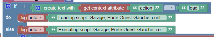

  1. I updated all scripts/rules to test the string in the special item’s metadata namespace named after the script/rule ID, so if it’s “load” it does nothing and update the namespace value to “run” for next run to do the stuff.
    => I probably can remove that and implement the “event” test, as suggested by @rlkoshak – I’ll check that particular idea later.
example of a rule updated with that test:
Adding precision: the event idea does not work, as it is defined in the execution of the 1st script (the one that does a loop to execute all others) but is not in the others.
I could probably change the design and create a rule for each script/rule to be executed when the system reaches level 100 (end of openhab start) and then, test the event that would probably be defined, but it would be more work than the current design, so I keep things as it is now.

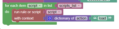

This is a pretty clever approach. I think there might be a slightly cleaner way to do it this approach without the Item metadata.
When you call a rule from another rule, you can pass data to the called rule. That’s what the “with context” part of the block does. Instead of setting metadata, which is permanent and survives a restart which means it will eventually need to be cleaned up, you could pass a flag in the context when you run the other rule and use the “get context attribute” in the called rules.
I don’t have easy access to screenshots at the moment but from the calling rule you’d click on the gear for the “create empty dictionary” and add something like “init = true”.
Then in all the called rules you’d use “if not get context attribute init” to see if this rule was called by the initializing rule. I think that approach would be a little cleaner than using metadata because in the long run you’ll have to add logic or have to remember to remove rules from the Item metadata if you ever want to remove a rule from this initialization behavior. It also means you don’t have to do as much work in the called rules as all you have to to is test for init. If init isn’t defined, the if condition will pass and the body of the rule will run (that’s why the “not” is in there). You don’t need the else or the blocks to reset the metadata.
Why not just have the one rule and have it triggered both with the Item and the system start level? Besides commanding OFF to the item_load_scripts_and_rules Item action are they any different?
If you use the context to pass data, you also don’t need the item_load_scripts_and_rules Item any more. You could have just the one rule that is triggered by the system runlevel which, when you need to initialize the rules you can run manually without commanding an Item.
I use this idea in my rule templates so I know it works. Show what you tried.

  • by adding a system runlevel trigger (note that with a system runlevel trigger the rule will run immediately upon being saved, saving you the extra step
  • by running the rule from another rule
You don’t have to command an Item or go somewhere else to initialize the rule as well as creating a system run level rule to run them at system started.

Hi Rich,
Yes indeed, I did not know this way of passing information from one script calling another one, but that is much better than using the metadata on an item. Using metadata works but it’s certainly slower, as it stores and retrieve the information from somewhere in the disk – metadata being persistent.
So, the “load scripts and rules” script executed at level 100 after openhab service is started became:
and in each script the test to run it “blank” and do nothing but load the helper library in memory became:
or, simpler, as you suggested:
=> there is no “loading script” log message anymore, but now we do know it’s working, that is not needed anymore.
That’s better, lighter and faster. Thanks for the tip!
Yes, the item_load_scripts_and_rules is not actually needed (no use of metadata requiring an item). At startup, the “load scripts and rules” script is executed on event “level 100 reached”.
We can keep it to have a matching button in some UI page to manually trigger the “load scripts and rule”, or not, that’s whenever we like.
Well, yes it works – what I meant is: it’s not applicable here. When a script is executed from another script, the event is not defined. In clear: when the “load scripts and rules” script is executed by the rule “start level 100 reached”, there is an event defined in it. Then it runs all scripts/rules we need to run “blank” and in them, the event is not defined. We could imagine test “if event is not define” then run “blank” but … some of these scripts are atomic actions that are also called from other scripts… therefore must “do something” in that case, where the event won’t be defined either.
The event idea is therefore not the right one to use in that use case. The run with context definitely is!
