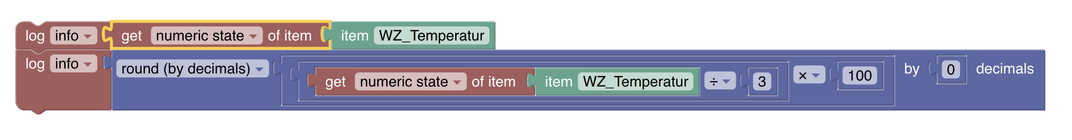

You can use the following to get the value only from that item without the quantity and then do the math
I will play with this.
