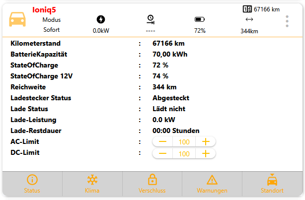

Hi @marcusb, hi @florian-h05,
i built an Widget for SemanticHomeMenu for my Cars showing and making settable the available Data from my Cars in a compact form.
I stumpled upon that for my Ioniq5 the AC- and DC-Limit are created as :
type: number:dimensionless - Point > Status > Energy
This doesn’t allow to change the setting, what is possible with the Hyundai App.
Changing the item to a setpoint doesn’t help, so i think the binding isn’t able the treat this datapoint as setpoint.
Could you have a look into this ?
The binding is working really great and helped me circumvent the situation that my OpenWB WallBox stopped the support for SoC-Data for Kia/Hyundai and also node-red with bluelinky is more a pain as a working solution.
So many thanks for this great Binding.
Greetings
Stephan Sandmann
Setting the charge limits is already supported on the API layer of the binding, see:
… and for the different regions (CA, EU,US) these methods are implemented.
We just need to expose that functionality and make the related Items read-write.
