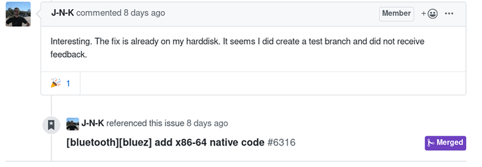

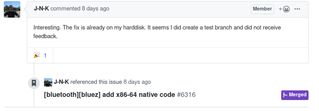

Ii appears there is a fix. It should work in 2.5M4.
I am on openHAB 2.5.0.M4 Milestone Build
Not yet :wink:
Upgrade to the latest snapshot or wait for the M5. I’ll try my luck with the former.
Latest snapshot is still not working for me. I’ve updated the issue with details.
Has it been determined what the scope of the problem is? Is it the combination of OH 2.5.0 and Raspberry? I couldn’t figure it out from the issue #5680. You’d think there to be more noise if this was happening to everyone using bluetooth.
For the record, same problem here with (Openabian) OH 2.5.0-1, Raspberry Pi 3 Model B Plus Rev 1.3.
I believe the openHABian image is 32-bit. According to the posting above the issue was fixed for 64 bit versions.
