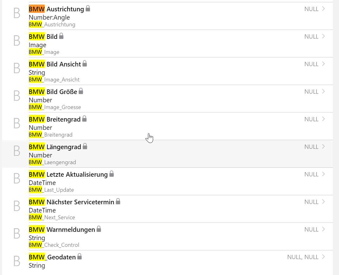

Hello Bernd,
I was using your binding with openhab 2.5 and it was working like a charm (openhabian on Raspi 4).
Yesterday I upgraded to OH3, downloaded the version 3.1 of your binding (newest version) and placed it into this folder:
/usr/share/openhab/addons/

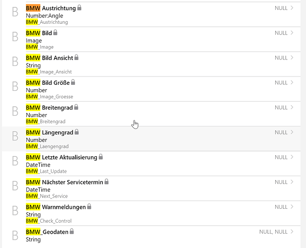

The problem is that the binding is not working anymore - all my items are on status “NULL”:
Is there something else I need to do, while upgrading from OH 2.5 to OH 3?
Thank you,
Mario

I suggest to start checking the Thing. One finding from the official review is that Thing identifiers shall not be upper case . So Things definition changed from e.g. BEV_REX to bev_rex .
So if your Thing Status is offline try this first.

Hello! Thanks for your reply.
I found the problem and fixed it?
I was getting the .jar file direclty on openhabian with SSH command “wget”.
This was leading to the problem that the BMW binding was not available.
Now I created a new Samba share to be able to copy the .jar file directly with windows explorer into the SAME folder and it´s working now!
Thank for the advice regarding lower case definition in the things file. Everything is up and running again in OH3.
