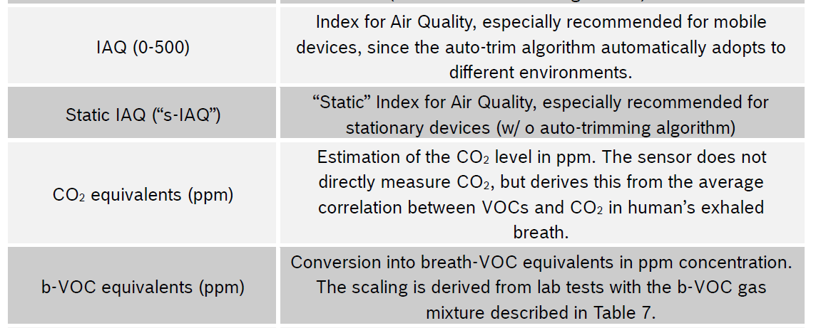

Basically, the gas sensor seems to be sensitve to H2S and all additional gas concentrations are derived from the H2S measurement - and machine learning isn’t magic. I would be impressed if the gas sensor could be used to classify coffee blends. :slight_smile: But you’re right: you get what you pay for and the sensor offers nice features for home use - but I wouldn’t rely upon it for gas alarms.

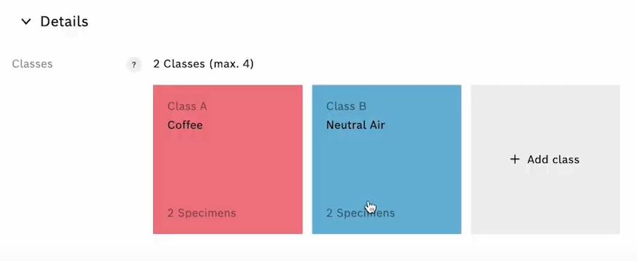

Fun point is that the bme688 code example is precisely to recognize the smell of coffee beans :slight_smile:
In the video they classify measurements into ‘coffee’ or ‘neutral air’ …
I would be mildly impressed, if they could train a predictor (with an acceptable confusion matrix) to discern between filter coffee and espresso.
