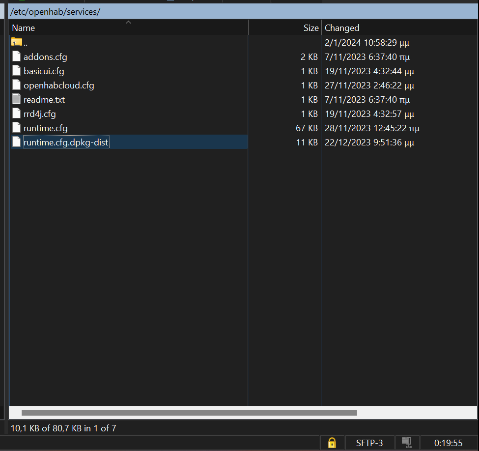

If there is anything not commented out in that file, it’s there because you put it there. And of course, if you’ve put something in that file, the apt upgrade isn’t going to remove it.
I see no error messages posted above. I see notification that the runtime.cfg file contained changes made by you so the apt upgrade did not replace that file with the distro version of the file. That’s not an error. That’s just information.
That’s not rubbish. Thats probably stuff left over from OH 2 or it stuff added by openHABian.
The “rubbish” is adding new “tiles” to PaperUI’s “home” page to open other URLs not part of openHAB. If MainUI uses these, this is how you add to the “Other Apps” menu at the upper right of the Overview page.
You can delete them or even delete the whole file. If these are used by MainUI it won’t be no impact. It will remove entries in “Other Apps” that point to various openHAB docs pages and Frontail.
Again, it was never an error in the first place. If you or anything else has modified any file under services, apt is not going to replace those and remove your changes and it’s going to tell you so. Everything is behaving as it should.
hello and thanks for taking the time!!
ok I understand the points you make. i now understand the connection between "Other apps and main UI with the CFG file. allow me to rephrase/correct my questions to be sure i am correct in my understanding.
a) in the image below - this is the folder containing the cfg files. there is a file which ends in dpkg-dist which has a 22/12 date - is this file random or is it the file which wasnt updated? (i.e. the 4.1 version default?)
b) i compared the two runtime files in this folder based on the assumption of my question a above that the dpkg-dist file is the newer one.
the differences are.
  1. my active version has this org.apache.karaf.shell:sshHost = 0.0.0.0 while the other has it # infront . i assume this is ok
  2. the newer file has a section saying webclient which reads as below (in code fences :slight_smile: - this is all commented out but it is missing from my one - suggesting that if I ever want to use this functionality i would have to add it manually going fw. is this correct? because while i understand that an update shouldnt edit your existing CFG, shouldnt it append? or is it of such little importance it isnt needed.
  3. the second code fence part and this is prob my main question(which you say is part of the main ui /other apps) notably i see two issues.
    a)the openhabiandocs… Openhabian Help section exists as uncommented 3 identical times and i havent added it in any way i am aware and it appears as “rubish” to me.
    b) where it says ip (.165) - ip 165 was the original one setup. but i changed it afterwards. i found an article now that explains that this happens when you make a change in ip later and can be corrected manually in the file.
so i think i could delete the two help items and fix my ip but then i am still wondering how a newb like me would gain from the new elements of the updated version of CFG files/files if it doesn’t update if you have existing changes made.
hope i explained better

This is the version of the file that comes with the update. If you want to use what comes with the package instead and throw away your changes to these files, you can remove runtime.cfg and rename runtime.cfg.dpkg-dist.
But there’s no reason to. None of these files contain anything (i.e. it’s all just comments, no real content) unless you change them (or something like openHABian changes them).
That allows ssh connections to the karaf console from any host, not just localhost. The default config is to only allow connections from localhost.
No. I think you vastly underestimate how challenging it is to merge changes like that.
And these are all just comments. There is nothing functional here. It’s just some inline documentation.
Because the name is the same, only the last one is used. It’s probably a minor bug in openHABian. It’s not a problem. The “random” text at the end is a base64 encoded icon image.
Well, that’s the URL to Frontail. It needs to match where Frontail is actually running, or if you are not using Frontail (or openHABian for that matter) you can remove any or all of these lines.
But the most important part is there is no problem here. There wasn’t a problem in the first place.
These files never have functional updates. In those rare events where there are changes to these files, the changes are always commented out, because the only purpose for these files is to document some of the settings you can make to the OH system and you are not using MainUI to configure OH.
If you are Hard Core TM and don’t want to use no UI to configure OH, then you had better know enough about all these files to modify them and keep them up to date and understand how apt works when it updates and how to merge them.
Everyone else should pretend these files don’t exist.
Frankly, if you are a noob and/or don’t understand what these files do or how they work, you shouldn’t care what is going on with these files at all. You’ll be doing all your config in MainUI anyway. Note that you cannot mix and match configurations though. If you, for example, decide to install an addon by using addons.cfg instead of through MainUI, you have to install all your addons using addons.cfg.
