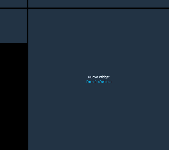

in all this cases i received in a dummy pannel the output: “i’m alfa u’re beta”

yes, in event.log file work, but in the dummy pannel on localhost:8080/habpanel didn’t
there wasn’t nothing in the next line, i guess because i tried some variants of \n
but the problem is not in log file, the problem is in my //localhost:8080/habpanel (in a widget) , even if in log file it show me the right way, in habpanel don’t

Okay, so your Item is absolutely fine, and you have a problem configuring your HABpanel.
Tag your post ‘HABpanel’ instead of ‘rules’ for better attention.
None of the sitemap based UIs support multiline Item content, so this is not used often.
I’ve not seen any multiline custom HABpanel widgets, but I would have thought you could make one.
