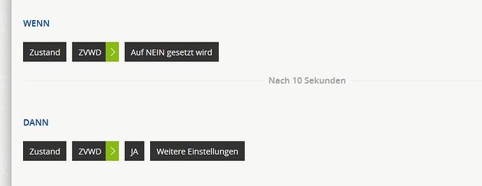

And here is the innogy scenario
I did not expect there is so much interest in this. Feel free to ask questions and I’ll try to help
