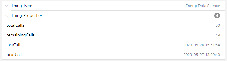

This time we received all the prices expected, so next call with be 13:00:40 tomorrow.
If the call is successful and we get tomorrow’s prices as expected, yes, then no further calls will be made. If the call fails, or if we didn’t get the expected prices for tomorrow, there will be further attempts. The time until next attempt depends on the situation, but in both cases there is an exponential back-off strategy with different parameters (aggresiveness).
No, it never gives up. There are properties available allowing you to track the status:
