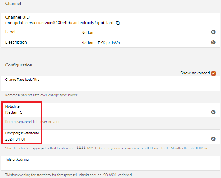

This depends on your Thing and channel configuration, i.e. which grid company you are using and if you have custom filters for the grid tariff channel. I can see from previous messages that your grid company is Radius, and they recently made some changes. The built-in filter has been adjusted accordingly:
To fix it in the version of openHAB you are using, you can configure the channel like this:

Strange I cannot seem to save the configuration for the channel, maybe a bug in OpenHAB? Or could it be because I configured the item in items file? Is there a way to configure the channel by text file?

Yes, it’s not a bug, you cannot edit unmanaged configuration in the UI. See channel configuration parameters here: Energi Data Service - Bindings | openHAB - and an example here: Energi Data Service - Bindings | openHAB
Yes, that should give almost the same result, since the JSON for that channel changes every hour when older prices slides out of scope. The only exception is that when receiving new spot prices slightly after 13:00, the hourly-prices channel would also update. I don’t know if that makes a difference to you, it depends what the purpose of “knowing anything changed” is.
Thank you, it works now :slight_smile:
