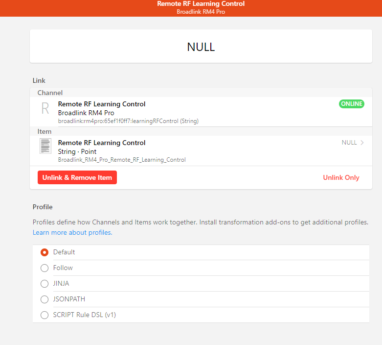

I also created a string Item for codes learning (as instructed in the documentation), but there is no option to “click” the NULL square to put the RM4 Pro into learning mode, and no popup menu appears.
Click the item, and click the rectangular area that is marked NULL
In the pop-up menu that appears, select Delete IR command for IR or Delete RF command for RF

I tried to follow the learning instructions, but when I get to the item page an try clicking on the null, no menu was available when clicking the NULL.
If I try the command item, the Null is can be clicked and menu comes up with only “cancel” option.
