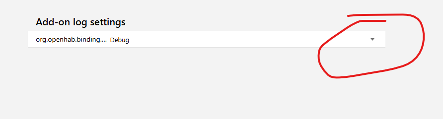

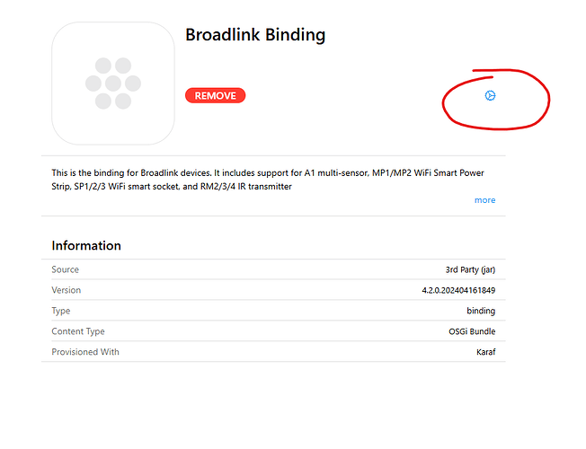

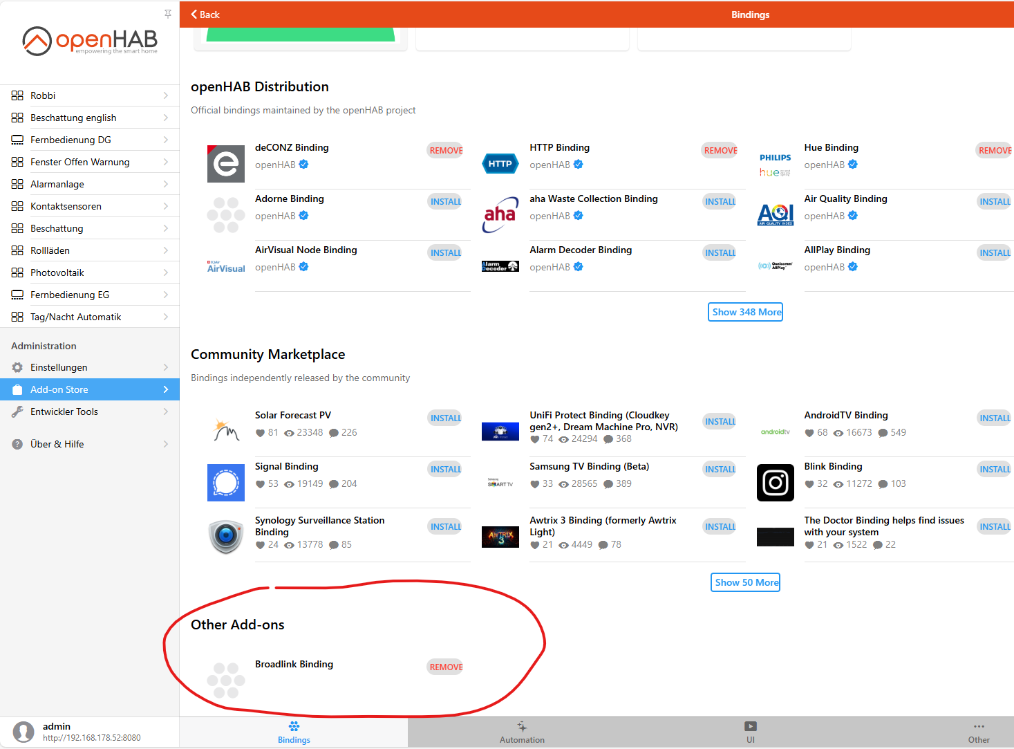

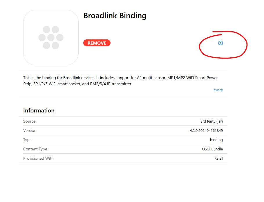

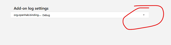

@mjeshurun Can you see the binding in the UI? It should appear there in the section “Other Add-Ons”.
There you can also configure the logging for the binding, see my screenshots

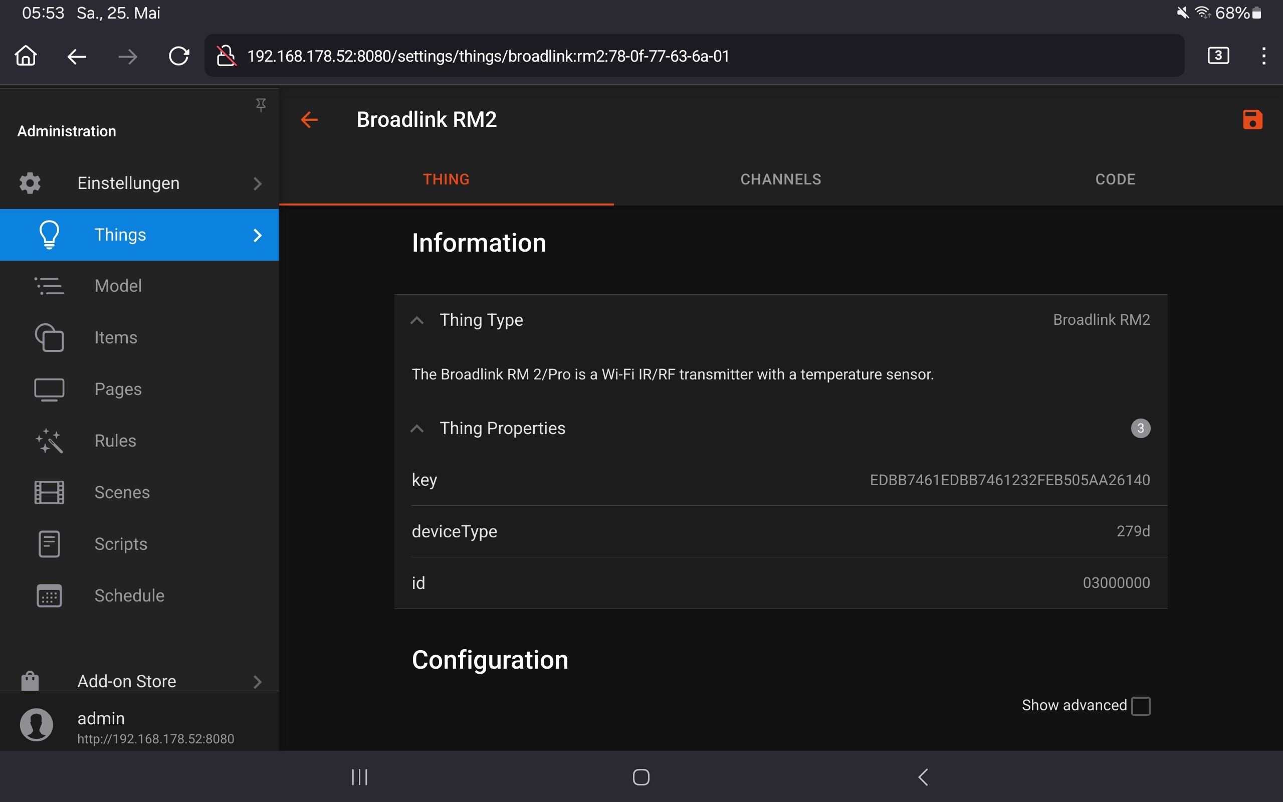

  • IR/RF should also work for your RM Pro. Which device type is reported by the thing created for the RM Pro?
The RM Pro is reported as RM2. But the thing was created with the old binding.

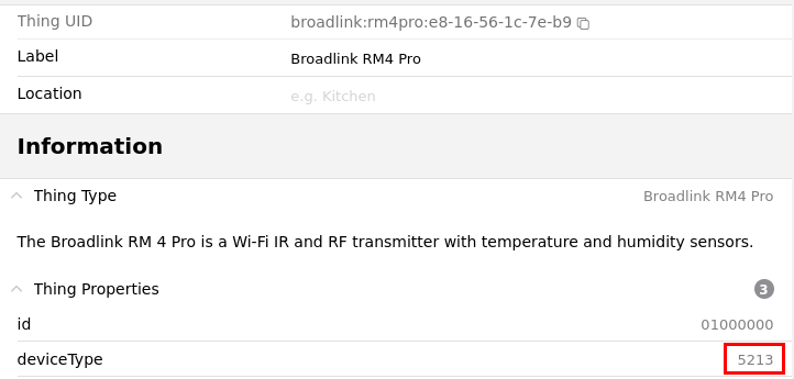

I think the mapping of the deviceType is wrong. Could you share what deviceType is reported on the Things page? It should look like this when you expand the Thing properties:
Please let me know which number is reported for the deviceType (as highlighted in the red box in the picture).
