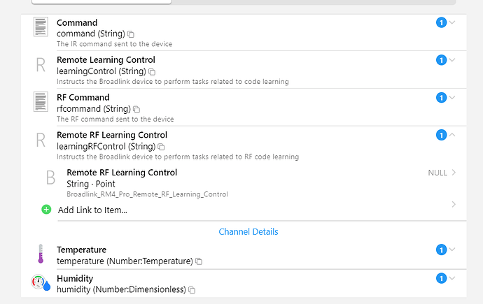

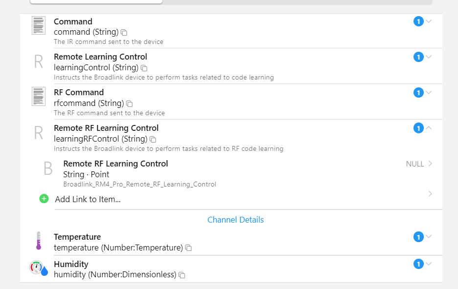

Hi @AntonJansen,

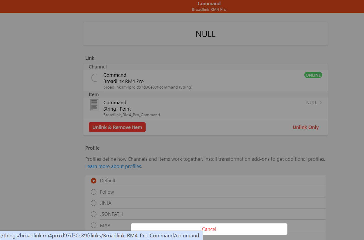

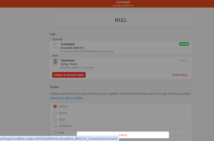

Yes, I created an Item for each channel of the RM4_pro thing, see below. I am running Openhab 4.1.3 in docker. Last image shows the single “cancel” menu I get when I click the null for the command item. I can’t see either rf.json or ir_json in jsondb folder.

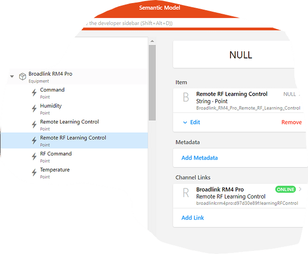

@rharman See my screenshots

That is the NULL I have tried to click.
For command items I can click it, but only the cancel appears in the menu at the bottom.
For learn items I can’t click the null at all.
Any suggestions?
The screenshot you posted show a different view. Are you sure you are in the model where the item is and not in the editor of the item?

Hi @Bernd_Ritter
It’s the same behaviour on the model page as well.
