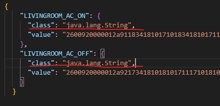

Hey guys, I’ve also updated to OH 4.2 M4 and installed the broadlink addon (jar). I’ve converted my old map file, but now I see the following error in the log, when executing any command. Do you have any idea what could be wrong?
2024-07-02 02:01:29.774 [ERROR] [nal.common.AbstractInvocationHandler] - An error occurred while calling method 'ThingHandler.handleCommand()' on 'org.openhab.binding.broadlink.internal.handler.BroadlinkRemoteModelProHandler@9129894': Cannot invoke "org.openhab.binding.broadlink.internal.BroadlinkMappingService.lookupCode(String, String)" because "this.mappingService" is null
java.lang.NullPointerException: Cannot invoke "org.openhab.binding.broadlink.internal.BroadlinkMappingService.lookupCode(String, String)" because "this.mappingService" is null
	at org.openhab.binding.broadlink.internal.handler.BroadlinkRemoteHandler.lookupIRCode(BroadlinkRemoteHandler.java:315) ~[?:?]
	at org.openhab.binding.broadlink.internal.handler.BroadlinkRemoteHandler.handleCommand(BroadlinkRemoteHandler.java:246) ~[?:?]
	at jdk.internal.reflect.NativeMethodAccessorImpl.invoke(NativeMethodAccessorImpl.java:77) ~[?:?]
	at java.lang.reflect.Method.invoke(Method.java:568) ~[?:?]
	at org.openhab.core.internal.common.AbstractInvocationHandler.invokeDirect(AbstractInvocationHandler.java:147) [bundleFile:?]
	at org.openhab.core.internal.common.InvocationHandlerSync.invoke(InvocationHandlerSync.java:59) [bundleFile:?]
	at jdk.proxy384.$Proxy514.handleCommand(Unknown Source) [?:?]
	at org.openhab.core.thing.internal.profiles.ProfileCallbackImpl.handleCommand(ProfileCallbackImpl.java:95) [bundleFile:?]
	at org.openhab.core.thing.internal.profiles.SystemDefaultProfile.onCommandFromItem(SystemDefaultProfile.java:49) [bundleFile:?]
	at org.openhab.core.internal.common.Invocation.call(Invocation.java:52) [bundleFile:?]
	at java.util.concurrent.ThreadPoolExecutor.runWorker(ThreadPoolExecutor.java:1136) [?:?]
	at java.util.concurrent.ThreadPoolExecutor$Worker.run(ThreadPoolExecutor.java:635) [?:?]
[UPDATE]
I did one little change based on some others comment, I’ve added the java data type into the broadlink_ir.json and restarted the binding. Now everything is working as expected!
