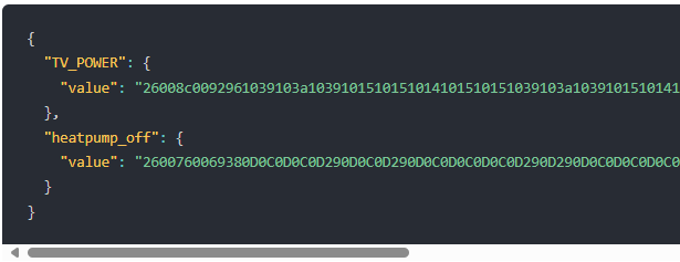

Hi @AntonJansen, first of all thank you very much for your great work to get this binding finally into official 4.3 release!
While migrating to day I face an issue that your converter script for my existing map file was failing with an error message.
Therefore I decided to create the $OPENHAB_USERDATA/jsondb/broadlink_ir.json manually.
After creation of the json file I was receiving the following error when starting the broadlink binding:
2024-12-30 12:20:56.811 [ERROR] [nal.common.AbstractInvocationHandler] - An error occurred while calling method 'ThingHandler.initialize()' on 'org.openhab.binding.broadlink.internal.handler.BroadlinkRemoteModel3Handler
@5ffcb5d': Object {} is not an outer map: {"MODE_ABLUFT":{"value":"26005800000126951338111412131213121411141114121312131239113912391139123911391238121411141114121312391114121312131239113912391139121312391139123911000516
0001264a12000c5a0001264a12000d05"},"MODE_INVERTER":{"value":"26006000000126951238121411141114121312131214111411141238123911391239113912381239113912131214111412381213121411141213123911391238121411391238123911000515000126
4b12000c580001264b11000c590001264b12000d050000000000000000"}}
While troubleshooting and reading the community forum I discovered that the binding documentation is outdated and missing the "class": "java.lang.String":
After I had adjusted my json the binding is starting without any error and everything is working fine
  "MODE_ABLUFT": {
    "class": "java.lang.String",
    "value": "260058000001269513381114121312131214111411141213121312391139123911391239113912381214111411141213123911141213121312391139123911391213123911391239110005160001264a12000c5a0001264a12000d05"
  "MODE_INVERTER": {
	"value": "260060000001269512381214111411141213121312141114111412381239113912391139123812391139121312141114123812131214111412131239113912381214113912381239110005150001264b12000c580001264b11000c590001264b12000d050000000000000000"
  "HUMID_LOW": {
    "value": "260050000001269513381114121312131214111411141213121312391139123911391238123912381214111411141238121411141114121312391238123812141139123812391238120005150001264b12000d050000000000000000"
  "HUMID_MED": {
    "value": "260050000001269513371214111412131213121411141114121312391337123812391139143713371213123913121238121411141114121312391114123812141139123911391337120005160001254b12000d050000000000000000"
  "HUMID_HIGH": {
    "value": "260050000001269512381214111411141213121312141114121312391139123812391238123911391239111411141238121411141114121312131239113912141139123812391139120005150001254b12000d050000000000000000"
  "FAN_POWER": {
    "value": "260050000001259611391214111411141213121312141114111412391139123812391139123911391214111411141213121312141114121312391139123911391238123912381239120005150001274a13000d050000000000000000"
Again, thanks a lot for your effort with this binding!
