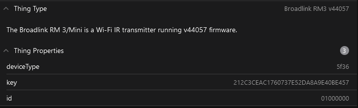

Thanks for the information. Can you share with me the information you have of the thing you created under the “Information” section? I need to know the Thing type and the 3 Thing properties.

Here is the information page from the device.
