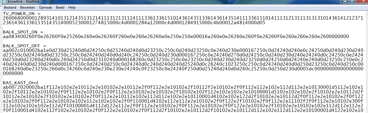

I have it working by just adding an item in my .items file and also in the broadlink.map file just like Cato showed in his example.
Map File Example:
LR_TV_HDMI=260050000001269214111312123712121312131212121312123713361312123713361235163513361312133613361411131212121336133614361311131212371336133613121212130005210001264a12000d050000000000000000
Item File Example:
String LR_TV_HDMI “LR_TV_HDMI” { channel=“broadlink:rm2:34-ea-34-cc-8c-a7:command” }

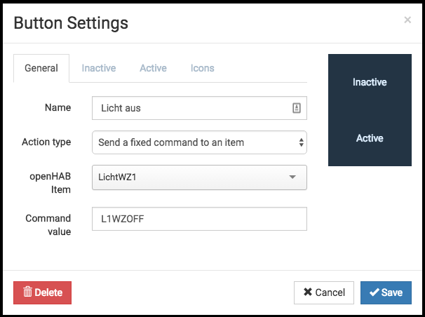

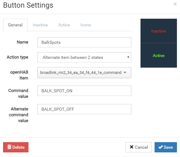

In Habpanel, add a “Button”, since this is my Living Room TV HDMI selection, I have shortened my naming to LRTV HDMI input. My button settings are:
Name= LRTV HDMI Input
Action type= Send a fixed command to an item
openHAB item= LR_TV_HDMI
Command value= LR_TV_HDMI
This works pretty good for all of my IR and RF items.

Your broadlink.map file on/off needs to match your Switch item, it should look like this:
L1WZON=b20634000b210b210a210a210b210b210a210a210b210b210b21200c0b210a210b211f0c0b21200c0a211f0c0b210b210a211f0c0b00014700000000
L1WZOFF=b2000c030a200a200a200a200a200a200a200a200a21092109211e0c0a200a200a201f0b0a201f0b0a201f0c09211f0b0a200a200a0001460a200a200a200a200a200a200a200a200a200a200a201f0c09200b2009211e0c0a201f0b0a201f0b0
a201f0c09210a200a00014609210a1f0a210a200a200a200a200a200a200a200a201f0b0a200a200a20200b0a1f200b0a201f0b0a201f0b0a200a200a0001460a200a200a200a200a200a200a210a2009210a200a201f0b0a200a200a201f0b0a201f0c
09211e0c0a201f0b0a200a200a0001460a200a200a200a200a200a200a200a2109200a2109211f0b09210a200a201f0b0a201f0b0a201f0c09211f0b0a200a200a0001460a200a200a200a200a200a200a200a200a200a200a201f0c0921092109211f0
b0a201f0b0a201f0c09211e0c0a2009210a0001460a200a200a200a2009210a200a200a200a200a200a201f0b0a200a200a211f0b0a201f0b0a201f0b0a201f0b0a2109210900014709210921092109210921092109210a20092109210a201f0b0a200a
2109201f0c09201f0c0a201f0b0a201f0b0a200a200a0001460a200a2109200a2109200a21092109210a20092109211f0b0a200a200a201f0b0a201f0c09211e0c0a201f0b0a200a200a0001460a2109200a200a2109200a200a200a2109200a2109211
f0b0a20092109211f0b0a201f0b0a211e0c09211e0c0a200a200a0001460a200a200a200a200a200a200a2109200a200a200a201f0c092109210a201f0b0a201f0b0a201f0b0a201f0c09210a20090001470a200a200a2009210a200a200a200a200a20
0a200a201f0b0a200a2109211f0b0a201f0b0a201f0b0a201f0c092109210900014709200a21092109200a2109210a200a2009210a2009211f0b0a200a200a201f0b0a201f0b0a211e0c1e0c1f0b1f0b1f0c090001460a200a200a200a200a200a200a2
00a2109200a210920200b0a201f0b0a201f0b0a201f0c0920200b1f0b1f0b1f0b1f0b0a0001460a2109200a200a200a200a200a210921092109210920200b09211f0b0a201f0b0a201f0b0a201f0c1e0c1f0b1f0b1f0b0a0005dc0a211e0c1e0c1f0b1f
0b1f0c
Then repeat this format for any additional items.
BK, thanky you! You are right. I have added several other RF codes into broadlink.map file. With this I was then able to create a Button in HabPanel, which was referencing to the RF codes. Here a picture of the Button Settings:
I did the same for the shutters. In general the control works, but it just moves a bit down and then stop. Double-clicking on the button makes the shutter go down completely, but this trick does not work out every time.
