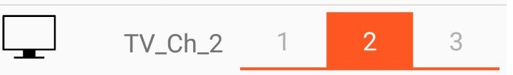

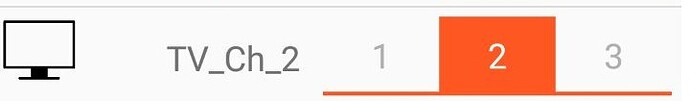

However, i am facing a weired issue in the Android app (the IOS app is working fine). the issue is that the value number of mapping is showing in the interface.
Please help, you can find the picture below to get what i mean. You will see the TV_Ch_2 showing next to the the item. and if i click Channel 1 it will change to TV_Ch_1 so how i can hide the mapping value in the “broadlink.map file” next to the item? And again this issue is only in Android app.
Thank you in advance
You need put .
Exemple:
Switch item=Harmony_Activity label=“TV” icon=“screen” mappings=[PowerOff=“Off”, PC=“PC”, TV=“TV”, PS4=“PS4”, OpenHab=“RPi”]
Regards
Thank you, Done !!
