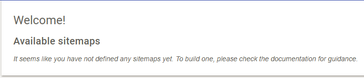

Hey Cato (or anyone that can Help me)
I followed the instructions carefully, but it’s not blasting T_T
I added the Temperature channel and that is being displayed correctly, but when I added the command channel on the Sitemap everything messes up:
Items:
//Broadlink RM Pro
Number BLRMP_TEMP "Temperature [%.2f °C]" (gChart3) { channel="broadlink:rm2:34-ea-34-89-17-17:temperature" }
String TV "TV" { channel="broadlink:rm2:34-ea-34-89-17-17:command" }
Sitemap:
Text item=BLRMP_TEMP label="Temperature [%.2f °C]" icon="Temperature"
Switch item=TV label="Power" mappings=[TV_ON="ON", TV_OFF="OFF"]
Broadlink.map
TV_ON = 00000071000000320080003F00100010001000300010001000100010001000100010001000100010001000100010001000100010001000100010001000100010001000300010001000100010001000100010001000100010001000100010001000100010001000100010003000100010001000100010001000100010001000100010001000100010001000100010001000100030001000300010003000100030001000300010001000100010001000100010003000100030001000300010003000100030001000100010003000100A98
TV_OFF = 00000071000000320080003F00100010001000300010001000100010001000100010001000100010001000100010001000100010001000100010001000100010001000300010001000100010001000100010001000100010001000100010001000100010001000100010003000100010001000100010001000100010001000100010001000100010001000100010001000100030001000300010003000100030001000300010001000100010001000100010003000100030001000300010003000100030001000100010003000100A98
those are the on/off codes for a Panasonic Plasma TV in case you need them.
Please HELP!!!
Remove the label and mappings from the switch item TV in the sitemap.
Switch item=TV
it´s working now!, when i pasted the code here I noticed that there were son strange characters on the sitemap, but it seems like it´s not reading the broadlink.map file, maybe is on the wrongpath or somethinganyone knows wich is the right place to create the map file?
The path where I placed the file is: /etc/openhab2/transform/broadlink.map
