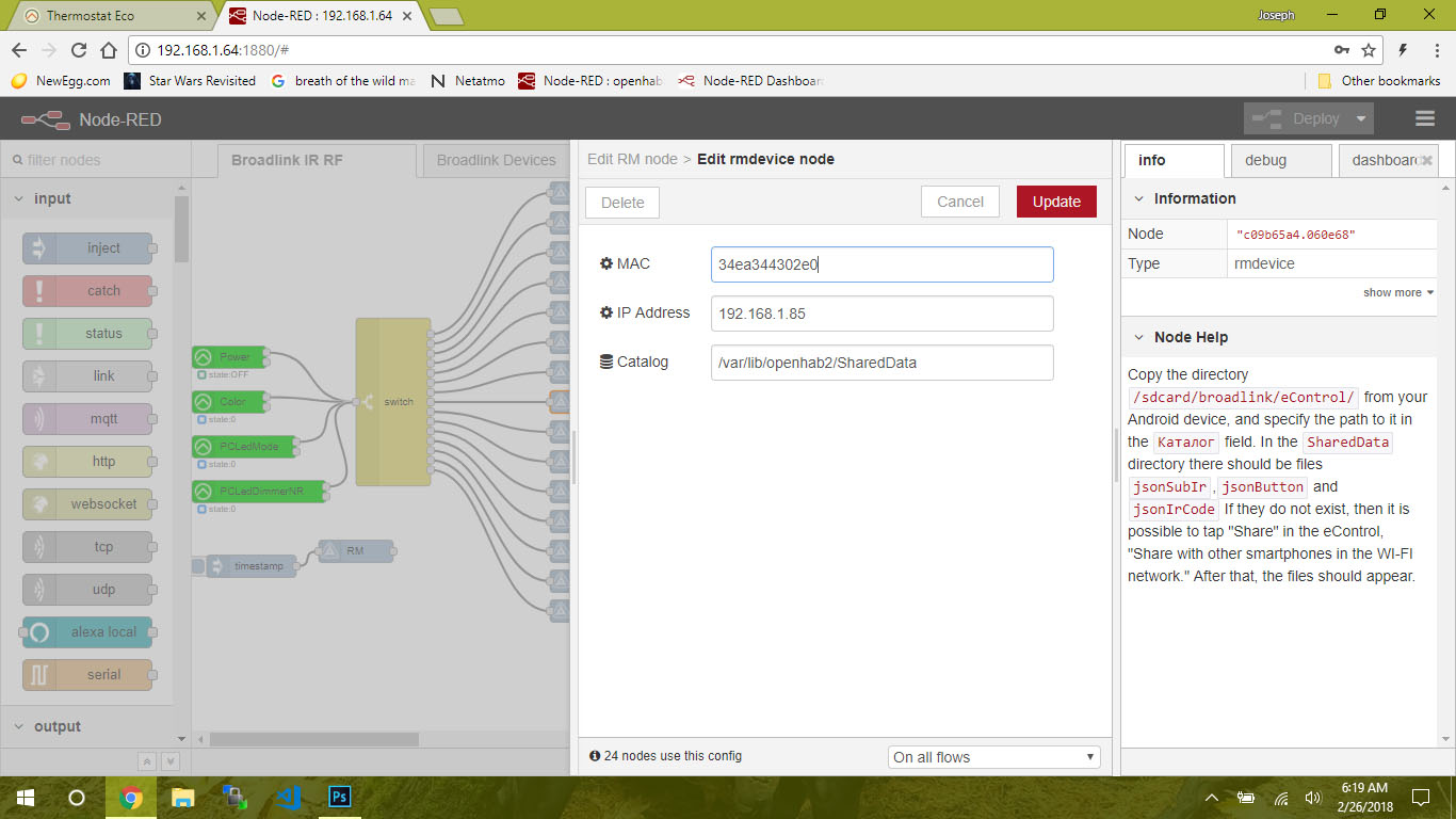

@jcf6288. I’m unclear what you meant by copying a folder off a phone and directing it to that folder. Is this an Android only? What folder should be copied? What is “it” that needs to be directed to that folder? How do the codes show up on that folder?
I am using android and am not sure about IOS. On android under broadlink there is a ShareData folder. Copy that to somewhere on you NODE-Red machine and direct the Node to that folder. It will grab the ir and rf codes and you can work from there.
Why? Isn’t it recommended the object specific way of calling item.sendCommand(NewState) instead of the generic one sendCommand(item, NewState)?
https://docs.openhab.org/configuration/rules-dsl.html#sendcommand-method-vs-action
Really interesting!

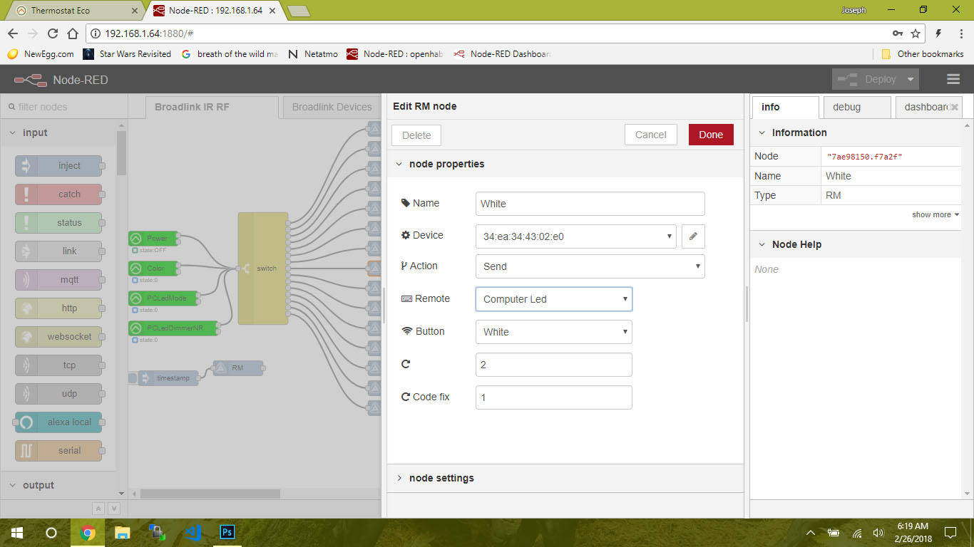

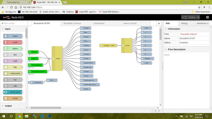

you mean that you are not using this binding but red node to manage RM ?
could you please share a screenshot of the config ?
As requested, node-red-contrib-broadlink is the one you want to use.
Thanks a lot but how did you integrate node red and openhab ?
This looks promising. I already some tests and it works. I can put the RM in learn mode but I don’t know where to store it and call it up later. Any tips?
Search in node red pallete for openhab
I am not sure where it is stored, I keep using the econtrol app and copy over the folder.
