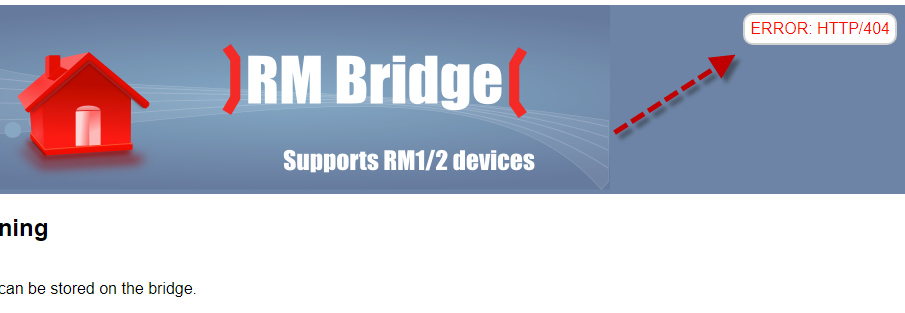

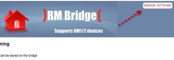

My challenge is getting the code to turn my VIZIO TV on or off.
I have attempted to use the site provided originally by CATO above
Yet when I try and enter either the iP or MAC address I see a 404 ERROR in the upper right hand corner of the page.
So does anyone have a way of learning the IR code? I can find the HEX of the code in many different places, yet no way to convert it into something that the Broadlink device can use.

Hi KidSquid,
you have to add the RM3 manually. Follow these steps:
  1. Download the mobile app RM Bridge on your phone
  2. the app will generate a URL with a port. Use this URL in the RM Bridge website in the Step 1
  3. Fill a Name for you device (anything) then fill the device’s MAC address then in the TYPE write RM3
  4. Click on add manually and you should be set

I know the IP address and the MAC address of the RM3…I tried entering both and still the page sends back the 404 error.
