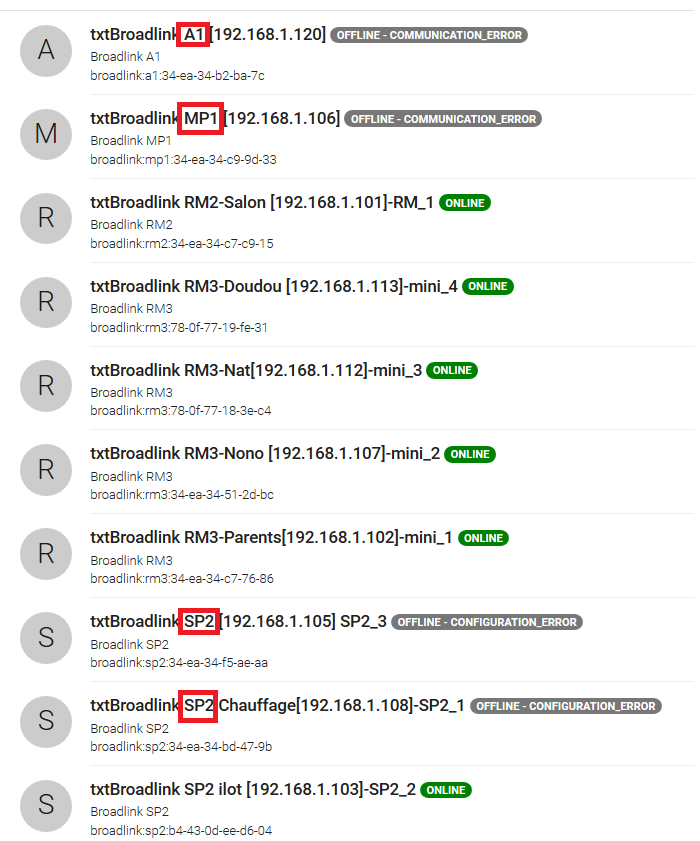

in fact, it didn’t help. i have several issues,
getting a lot of
[ERROR] [nk.handler.BroadlinkBaseThingHandler] - IO error: Broadlink Device: Socket is closed
MY A1, MP1 and SP2 are always offline
it didn’t happen with this flavour of the addon https://dl.bintray.com/themillhousegroup/generic/:org.openhab.binding.broadlink-2.4.0-BETA-10.jar with the same thing definition as below
Thing broadlink:sp2:34-ea-34-f5-ae-aa "txtBroadlink SP2 [192.168.1.105] SP2_3"                      [ ipAddress="192.168.1.105", port=80, mac="34:ea:34:f5:ae:aa",	authorizationKey="097628343fe99e23765c1513accf8b02", iv="562e17996d093d28ddb3ba695a2e6f58", pollingInterval=120 ]
Thing broadlink:sp2:b4-43-0d-ee-d6-04 "txtBroadlink SP2 ilot [192.168.1.103]-SP2_2"					[ ipAddress="192.168.1.103", port=80, mac="b4:43:0d:ee:d6:04",	authorizationKey="097628343fe99e23765c1513accf8b02", iv="562e17996d093d28ddb3ba695a2e6f58", pollingInterval=120 ]
Thing broadlink:sp2:34-ea-34-bd-47-9b "txtBroadlink SP2 Chauffage[192.168.1.108]-SP2_1"				[ ipAddress="192.168.1.108", port=80, mac="34:ea:34:bd:47:9b",	authorizationKey="097628343fe99e23765c1513accf8b02", iv="562e17996d093d28ddb3ba695a2e6f58", pollingInterval=120 ]
Thing broadlink:a1:34-ea-34-b2-ba-7c  "txtBroadlink A1 [192.168.1.120]"                             [ ipAddress="192.168.1.120", port=80, mac="34:ea:34:b2:ba:7c", 	authorizationKey="097628343fe99e23765c1513accf8b02", iv="562e17996d093d28ddb3ba695a2e6f58", pollingInterval=120 ]
Thing broadlink:mp1:34-ea-34-c9-9d-33 "txtBroadlink MP1 [192.168.1.106]"                            [ ipAddress="192.168.1.106", port=80, mac="34:ea:34:c9:9d:33",  authorizationKey="097628343fe99e23765c1513accf8b02", iv="562e17996d093d28ddb3ba695a2e6f58", pollingInterval=120 ]
Please could you advise?

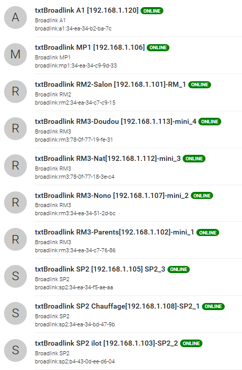

Thank you. Please try:
https://drive.google.com/file/d/1kUPApDmXFKjxtL92ElOr46zb8P95A6yh/view?usp=sharing
And post results and logs.
i have a good news . From the console i have removed a previous versions of the broadlink addon
and Now all green!
