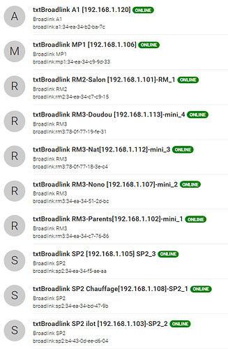

The thing configuration is text file:
Thing broadlink:sp2:34-ea-34-f5-ae-aa "txtBroadlink SP2 [192.168.1.105] SP2_3"                      [ ipAddress="192.168.1.105", port=80, mac="34:ea:34:f5:ae:aa",	authorizationKey="097628343fe99e23765c1513accf8b02", iv="562e17996d093d28ddb3ba695a2e6f58", pollingInterval=900 ]
Thing broadlink:sp2:b4-43-0d-ee-d6-04 "txtBroadlink SP2 ilot [192.168.1.103]-SP2_2"					[ ipAddress="192.168.1.103", port=80, mac="b4:43:0d:ee:d6:04",	authorizationKey="097628343fe99e23765c1513accf8b02", iv="562e17996d093d28ddb3ba695a2e6f58", pollingInterval=900 ]
Thing broadlink:sp2:34-ea-34-bd-47-9b "txtBroadlink SP2 Chauffage[192.168.1.108]-SP2_1"				[ ipAddress="192.168.1.108", port=80, mac="34:ea:34:bd:47:9b",	authorizationKey="097628343fe99e23765c1513accf8b02", iv="562e17996d093d28ddb3ba695a2e6f58", pollingInterval=900 ]
Thing broadlink:a1:34-ea-34-b2-ba-7c  "txtBroadlink A1 [192.168.1.120]"                             [ ipAddress="192.168.1.120", port=80, mac="34:ea:34:b2:ba:7c", 	authorizationKey="097628343fe99e23765c1513accf8b02", iv="562e17996d093d28ddb3ba695a2e6f58", pollingInterval=900 ]
Thing broadlink:mp1:34-ea-34-c9-9d-33 "txtBroadlink MP1 [192.168.1.106]"                            [ ipAddress="192.168.1.106", port=80, mac="34:ea:34:c9:9d:33",  authorizationKey="097628343fe99e23765c1513accf8b02", iv="562e17996d093d28ddb3ba695a2e6f58", pollingInterval=900 ]
Thing broadlink:rm2:34-ea-34-c7-c9-15 "txtBroadlink RM2-Salon [192.168.1.101]-RM_1"					[ ipAddress="192.168.1.101", port=80, mac="34:ea:34:c7:c9:15", authorizationKey="097628343fe99e23765c1513accf8b02", iv="562e17996d093d28ddb3ba695a2e6f58", mapFilename="RM_1_c.map", pollingInterval=900 ]
Thing broadlink:rm3:78-0f-77-19-fe-31 	"txtBroadlink RM3-Nat[192.168.1.112]-mini_4"				[ ipAddress="192.168.1.113", port=80, mac="78:0f:77:19:fe:31", authorizationKey="097628343fe99e23765c1513accf8b02", iv="562e17996d093d28ddb3ba695a2e6f58", mapFilename="mini_4_c.map", pollingInterval=900 ]
Thing broadlink:rm3:78-0f-77-18-3e-c4 	"txtBroadlink RM3-Doudou [192.168.1.113]-mini_3"			[ ipAddress="192.168.1.112", port=80, mac="78:0f:77:18:3e:c4",  authorizationKey="097628343fe99e23765c1513accf8b02", iv="562e17996d093d28ddb3ba695a2e6f58", mapFilename="mini_3_c.map", pollingInterval=900 ]
Thing broadlink:rm3:34-ea-34-51-2d-bc "txtBroadlink RM3-Nono [192.168.1.107]-mini_2"				[ ipAddress="192.168.1.107", port=80, mac="34:ea:34:51:2d:bc", authorizationKey="097628343fe99e23765c1513accf8b02", iv="562e17996d093d28ddb3ba695a2e6f58", mapFilename="mini_2_c.map", pollingInterval=900 ]
Thing broadlink:rm3:34-ea-34-c7-76-86 "txtBroadlink RM3-Parents[192.168.1.102]-mini_1"				[ ipAddress="192.168.1.102", port=80, mac="34:ea:34:c7:76:86", authorizationKey="097628343fe99e23765c1513accf8b02", iv="562e17996d093d28ddb3ba695a2e6f58", mapFilename="mini_1_c.map", pollingInterval=900 ]
It’s most of the time stable but sometimes some things are offline due to communication error. OFFLINE - COMMUNICATION_ERROR

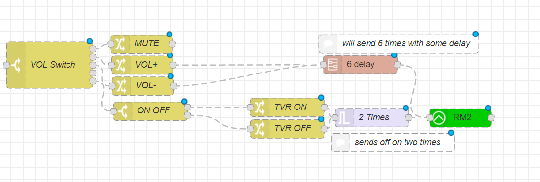

I’have problem with my Philips TV. It seems that my TV ignores signal if it comes right after same one (same code, same leght). So if I define in OH TV ON/OFF code (it’s obvious that it lenght is the same each time) then my TV ignores second one (treats as echo or something that is not desirable for some reason).
Have you some solution for that (except for periodic sending, for example, of “exit/cancel” TV buton code)?
i had that issues also, i resolved it with a set of rules that will send some actions twice at the same time
this way it will never get missed
maybe it will give you an idea
I think we misundersootd. :wink: In my opinion I have exactly oposit situation.
In my case one specyfied code sent twice (not button pressed code from original remote, but code sent from OH), for example on/off code, up button, etc., causes that TV ignores the second one and third and next ones (each one same as the first accepted). The reason for this is that OH have only one uniq code for each button that it have one specified signal lenght, and TV ignores that treating each next one like some kind of echo or something. That situation not ocures when using original remote, because each “button-pressed-signal” have inevitably different lenght.

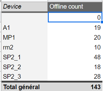

To summarize, in this google sheets, all the offline status are logged since 24 hours
the good news is that my 4 mini are working perfectly
Error for rm2

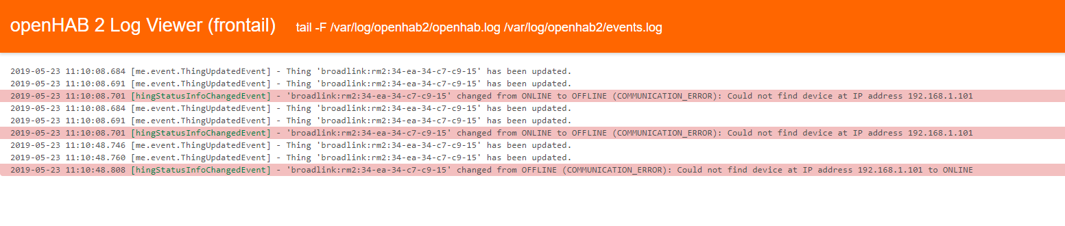

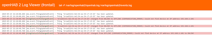

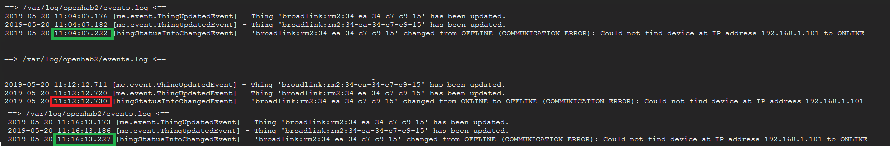

About the Rm2, i have seen something strange in the log. it’s changed twice from online to offline see below

I looked over your log files and there is no apparent reason for the Broadlink devices going offline. They just fail to respond every so often.
In an attempt to improve their reliability, I’ve added a simple retry function - so rather than immediately declaring a device “offline” when we don’t get an answer after 5 seconds, I resend the request again.
Hopefully this will fix whatever is causing your packets to get lost. If you really don’t want that retry behaviour you can go into the Thing configuration page in Paper UI; under Advanced you can set the “Retries” value back to 0.
Hope it helps!
