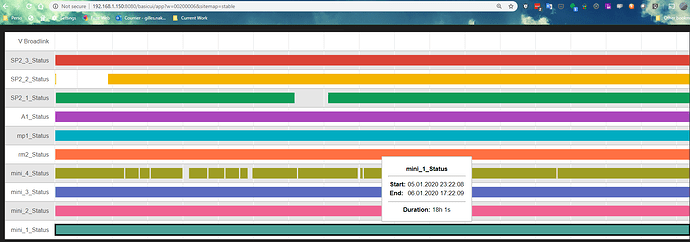

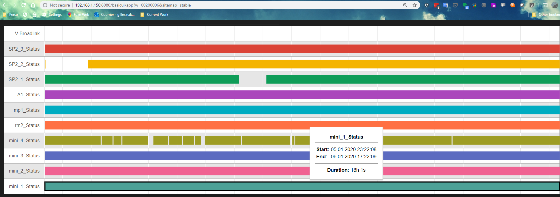

it;s really stable for RM2, mini, SP2, MP1, and A1
the logs below
2020-01-04 22:18:40.258 [INFO ] [.discovery.BroadlinkDiscoveryService] - BroadlinkDiscoveryService - Constructed
2020-01-04 22:19:07.649 [ERROR] [.handler.BroadlinkStripModel1Handler] - mp1:34-ea-34-c9-9d-33[?]: Authentication failed: {}
java.net.ProtocolException: Incoming packet from device is null.
	at org.openhab.binding.broadlink.internal.BroadlinkProtocol.decodePacket(BroadlinkProtocol.java:191) ~[bundleFile:?]
	at org.openhab.binding.broadlink.handler.BroadlinkBaseThingHandler.authenticate(BroadlinkBaseThingHandler.java:124) [bundleFile:?]
	at org.openhab.binding.broadlink.handler.BroadlinkBaseThingHandler.transitionToOnline(BroadlinkBaseThingHandler.java:243) [bundleFile:?]
	at org.openhab.binding.broadlink.handler.BroadlinkBaseThingHandler.updateItemStatus(BroadlinkBaseThingHandler.java:199) [bundleFile:?]
	at org.openhab.binding.broadlink.handler.BroadlinkBaseThingHandler$1.run(BroadlinkBaseThingHandler.java:75) [bundleFile:?]
	at java.util.concurrent.Executors$RunnableAdapter.call(Executors.java:511) [?:1.8.0_222]
	at java.util.concurrent.FutureTask.runAndReset(FutureTask.java:308) [?:1.8.0_222]
	at java.util.concurrent.ScheduledThreadPoolExecutor$ScheduledFutureTask.access$301(ScheduledThreadPoolExecutor.java:180) [?:1.8.0_222]
	at java.util.concurrent.ScheduledThreadPoolExecutor$ScheduledFutureTask.run(ScheduledThreadPoolExecutor.java:294) [?:1.8.0_222]
	at java.util.concurrent.ThreadPoolExecutor.runWorker(ThreadPoolExecutor.java:1149) [?:1.8.0_222]
	at java.util.concurrent.ThreadPoolExecutor$Worker.run(ThreadPoolExecutor.java:624) [?:1.8.0_222]
	at java.lang.Thread.run(Thread.java:748) [?:1.8.0_222]
2020-01-04 22:19:07.662 [ERROR] [.handler.BroadlinkStripModel1Handler] - mp1:34-ea-34-c9-9d-33[?]: Attempting to authenticate prior to getting device status FAILED. Will mark as offline
2020-01-04 22:19:07.664 [ERROR] [.handler.BroadlinkStripModel1Handler] - mp1:34-ea-34-c9-9d-33[?]: updateItemStatus: Online -> Offline
2020-01-05 02:00:50.283 [ERROR] [dlink.handler.BroadlinkRemoteHandler] - rm3:78-0f-77-19-fe-31[^]: updateItemStatus: Online -> Offline
2020-01-05 03:00:41.467 [ERROR] [dlink.handler.BroadlinkRemoteHandler] - rm3:78-0f-77-19-fe-31[^]: updateItemStatus: Online -> Offline
2020-01-05 06:18:27.589 [ERROR] [.handler.BroadlinkStripModel1Handler] - mp1:34-ea-34-c9-9d-33[^]: updateItemStatus: Online -> Offline
2020-01-05 06:25:32.765 [ERROR] [.handler.BroadlinkStripModel1Handler] - mp1:34-ea-34-c9-9d-33[v]: Authentication failed: {}
