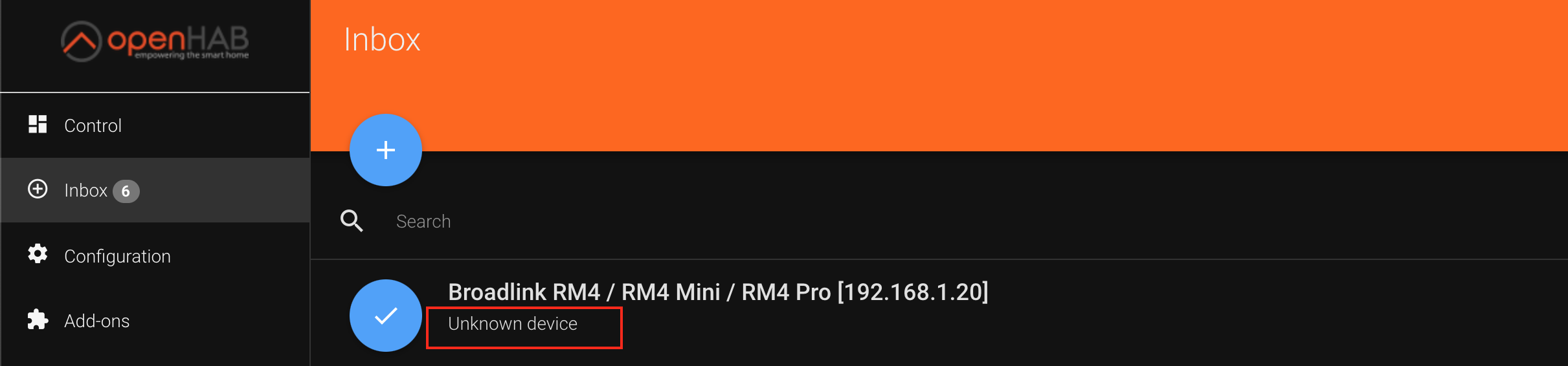

Hi John,
Thanks for the updated plugin.
OpenHAB now recognizes my device in the inbox, but i’m getting an “ERROR: 409 - Conflict” message when trying to add the thing.
Looks like the device isn’t fully recognized. Under the Broadlink RM4… title, it’s showing “Unknown device” (see screenshot).
Screen Shot 2020-04-19 at 10.58.29
409 conflict typically means there are remnants of your previous thing. It may not have been completely uninstalled. You may need to go into the REST api interface and make sure it’s fully removed.
Thanks for the explanation, @KidSquid.
I never added any Broadlink devices as things to my OpenHAB system before.
So I’m not sure what could cause the conflict
Sometimes just copying over the top of an existing .jar doesn’t cleanly upgrade.
It’s probably best to do it in discrete steps:
  • move the Broadlink .jar file out of your addons directory
  • let OpenHAB “recover” from that binding being unloaded (watch the logs until they are quiet)
  • then move the .jar back into addons.
