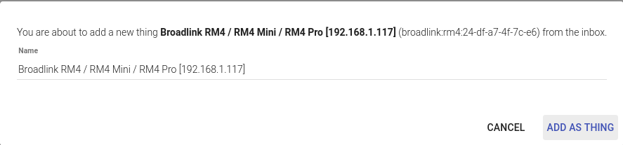

Clicking on the blue tick shows this:
Clicking ADD AS THING shows this popup in the bottom right-hand-corner of the screen, which disappears after a few seconds:
My log shows this:
21:09:00.727 [ERROR] [thome.core.thing.binding.ThingFactory] - Thing factory (class org.openhab.binding.broadlink.internal.BroadlinkHandlerFactory) returned null on create thing when it reports to support the thing type (broadlink:rm4).
21:09:00.745 [WARN ] [ig.discovery.internal.PersistentInbox] - Cannot create thing. No binding found that supports creating a thing of type broadlink:rm4.
I hope this helps a little in fixing!
