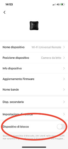

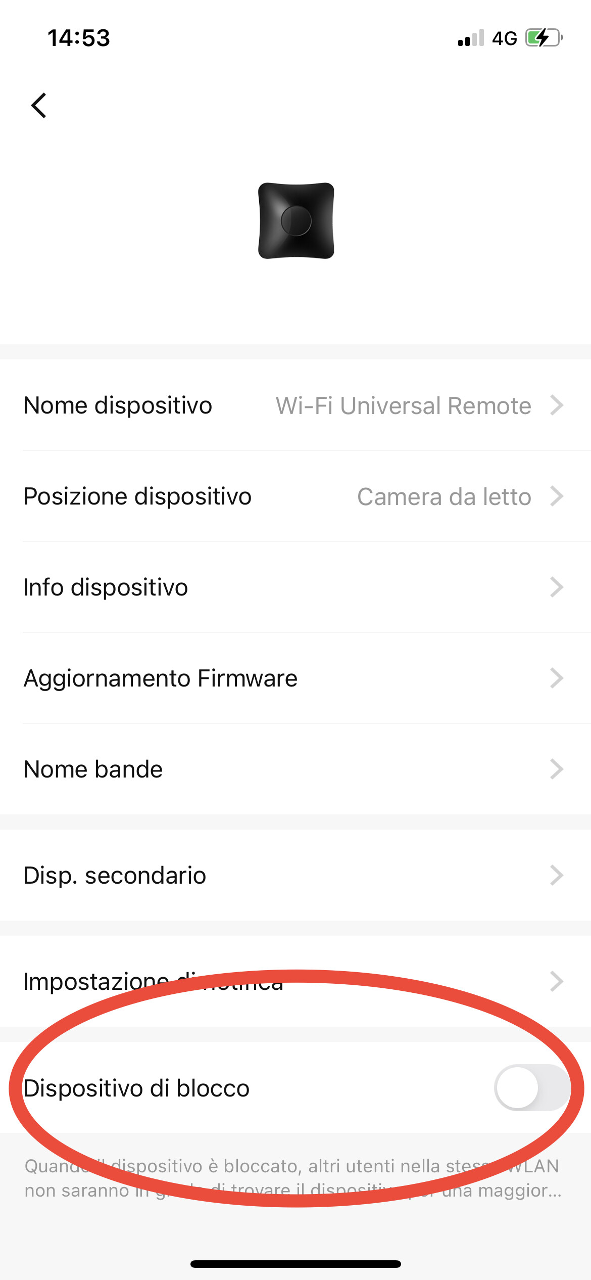

hello everyone, sorry for my English … for those like me who hit their heads in the error “couldn’t authenticate” the solution is in the smartphone application settings. In the device settings disable unlocking!
It has been taken more than three days to find exactly this settings in the broadlink app,
to find out, that this is was the root case that my binding was not working. OMG.
