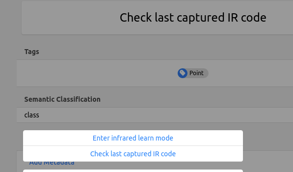

I have found the instructions here:
Now I can see how it works but it doesn’t autoupdate the learn file (broadlink.map) nor does the check the last IR learned.
So yes it sort of works:
I must be still not understanding something else.
I thought it updated the learn file now?
I manually added the IR code and gave it a command line and that worked as well.

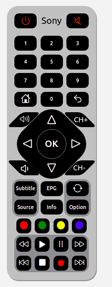

How did you send the command from the remote widget?
omg…reading this thread confused me a lot…installing the binding learning the commands,mqtt,using external programs…omg!I just want a clear answer,if i upgrade to openhab 3.1 is it easier to use this binding? what are the steps to send on/off commands to my airconditioners from RM4 mini using openhab ?I have already setup my devices through broadlink android app and also been able to use Google Assistant to command them…
Yes I am confused as well. the original post was 2017.
I have it working but don’t know how to get the commands from the remote control widget to the binding items.
It works from the gui.
