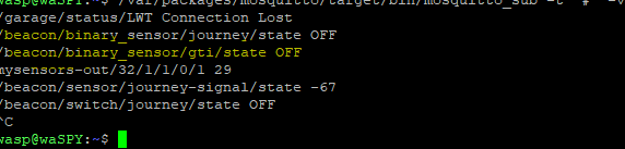

this got me thinking. when a node goes away and the LWT message is supposed to fire, would you still see it stored in the broker?
If it’s configured to be retained then yes. If not then it’s ephemeral. If a client doesn’t happen to be subscribed when the message fires it’s lost to the ether.
If that’s the case then AFAIK it’s not working
the third line
/beacon/binary_sensor/gti/state OFF
is the LWT of the beacon in my car that is most definitely disconnected at the moment.
This is what’s not working.

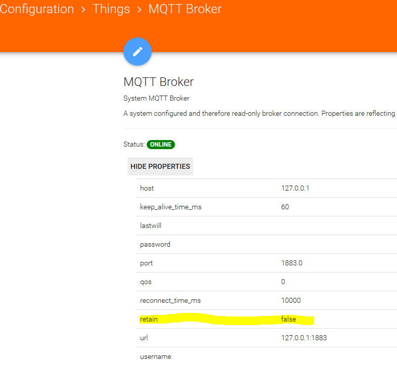

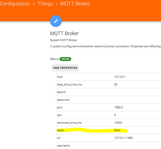

The client (i.e. the device sending the message or in this case configuring the lwt message to be sent on it’s behalf) defines whether the message gets retained or not. That parameter on the MQTT Broker Thing does not control that. I’m not sure that parameter on the broker does anything at all.
You topic is different. OP here is using Mosquitto. You are having problems with the Embedded Broker.
It tells if the broker connection will by default send retained or non retained messages. But that can be overridden for every channel.
