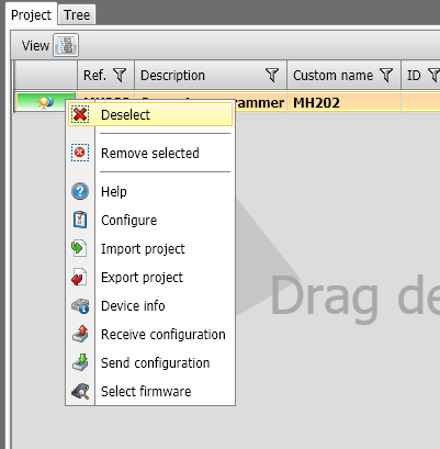

MyHomeSuite files are called plants. Within them are the devices. The one you need is MH202. Right mouse click on it and there should be options for import and export project as well as send and receive configuration. I never do much with project files except to back them up sometimes. It is the config you want. Select receive the config file. This will then be brought into your ‘project’ that is part of the MyHomeSuite .plant file. When you change anything in the config you then send the new config file. I think projects, . prj files, are for when you want to send or receive setups from someone else.

So first step is to create a new plant. Then search using the scanner for the MH202 on your system. When you find it you the drag it over into the main area. Save the plant. Next step is to receive the configuration. Save the plant. Once you have it saved you can then open the config file to view it and make changes. After you have made the changes you want select save and then save the plant. Then send the new confguration to the MH202. You will need the IP address and the password for the MH202.
