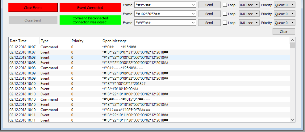

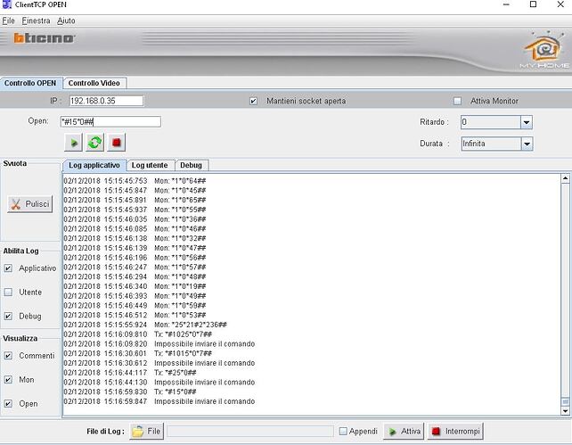

can someone here use the official bticino client (https://www.myopen-legrandgroup.com/developers/ → tab TOOLS) and then send these commands:
  1. *#15*0##
  2. *#25*0##
  3. *#1015*0*7##
  4. *#1025*0*7##
and then send me images of the output windows ?
bye
M

I did the test, no answer on all 4 frames
Yes: change the extension to .jar and follow the instruction on the binding README for upgrading from previous binding version.
M
You should at least have received a NACK response: *#*0##
Did you get it?
