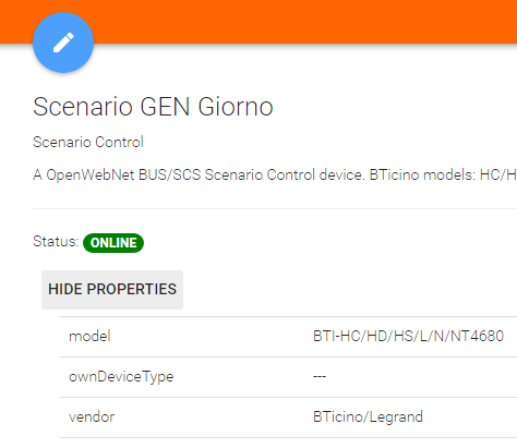

Test with beta9 with problems, channels are not created.
I tried the beta9-pre2 instead it works by modifying bus_scenario_control in bus_scenario_control4
Am I wrong?
.thing
Thing bus_scenario_control cen_gen_giorno "Scenario GEN Giorno" @ "Scena" [ where="2"]
.items
String CEN_TX_Tap_Giorno "T 1 GEN Giorno" <network> (C_Corridoio, G_Cen) [ "Lighting" ] { channel="openwebnet:bus_scenario_control:mybridge:cen_gen_giorno:button2" }
2018-12-15 16:05:42.578 [.ItemChannelLinkAddedEvent] - Link 'CEN_TX_Tap_Giorno-openwebnet:bus_scenario_control:mybridge:cen_gen_giorno:button2' has been added.
Edit:
Both automatic detection of CEN and pressure sensing did not work.
Hi Michele,
After a CEN/CEN+ device is added from Inbox, scenarioButton channels corresponding to physical buttons are added automatically after they are first activated from the physical device (refresh web page if needed).
So you will need to follow these steps:
start Scan > wait 15 sec > press one of the CEN buttons (eg button2) > it should appear a new CEN thing in Inbox > confirm it to add in the list of things > press again the same CEN button > refresh Control web page > only now after the channel is added it should appear the CEN thing with channel=button2
Can you test this and let me know?
I am already working to simplify this and have channels added during the scan-discovery phase.
The WHERE is wrong here: it must be always prefixed by a 2, so if the address of CEN Control device is 2 then the WHERE to be used is 22. I will add a note in the thing configuration.
You should change the WHERE to 22 and then pressure sensing should work.
