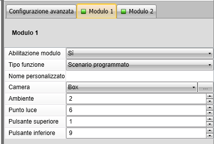

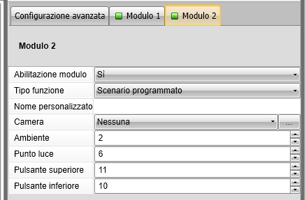

  • I modified the .things file by putting the “2” in front of it.
    But you have to press the physical button if it does not appear in the paperUI
    Can not you do it automatically?
I performed the test 6 times.
The first 3 nothing, the 4 found me only one CEN +, 5 and 6 the second does not recognize it.
