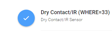

Hi Massi
I just ran a discovery using beta9-2 binding. All my F428 contacts ( where 33-38) were found but not my basic 3477 contacts interface 31, 32. Like last time I think.
3477 contacts are the small ones that fit inside enclosures and behind things etc. F428 is the DIN form factor for racks . Both are should be the same otherwise. If you could get the 3477 working that would be great for me :slight_smile:

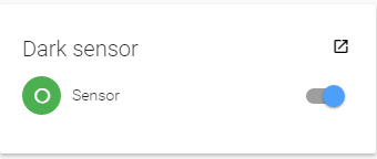

2019-01-20 21:02:54.592 [hingStatusInfoChangedEvent] - 'openwebnet:bus_dry_contact_ir:Screen10:31' changed from UNKNOWN: waiting state update... to OFFLINE (COMMUNICATION_ERROR): Could not get channel state
For those that were found it seems to work well
PaperUI shows correct state but sitemap does not until the contact state is changed. Update… Fixed this by creating a Thing in my thing file
Thing bus_dry_contact_ir 34 "Dark sensor"  [ where="34" ]
The contacts items are configured as switches .. correct?
Switch Dark_Sensor "Dark sensor"  <moon> {channel="openwebnet:bus_dry_contact_ir:Screen10:34:sensor"}

The discovery does not find the 3476 Basic
How can I help you ?
Try manually creating the Thing and item like this:
Things file
Thing bus_dry_contact_ir 31 "Garage door closed sensor"  [ where="31" ]
Items file
//3477 contacts interfaces
Switch GarageDoorClosed_Sensor "Garage door closed" <garagedoor> {channel="openwebnet:bus_dry_contact_ir:Screen10:31:sensor"}
Where in 31 the 1 is the contact number. Keep the three and just change the second number.
That worked for my 3477 interfaces even though they were not discovered by PaperUI
Thanks Mark,
I can make it work via file configuration.
My post referred to Massimo for completeness of your problem with the automatic discovery
Both 3476 and 3477 are not recognized for automatic discovery
