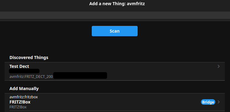

Hi Joachim,
just tested this with a new Fritz Dect 200 (FRITZ!Smart Energy 200)
It’s instantly in the Inbox:
I didn’t add any Items, but the Thing is online:
So at least it isn’t a general problem with the Binding. Other AVM Items work without any issue.
