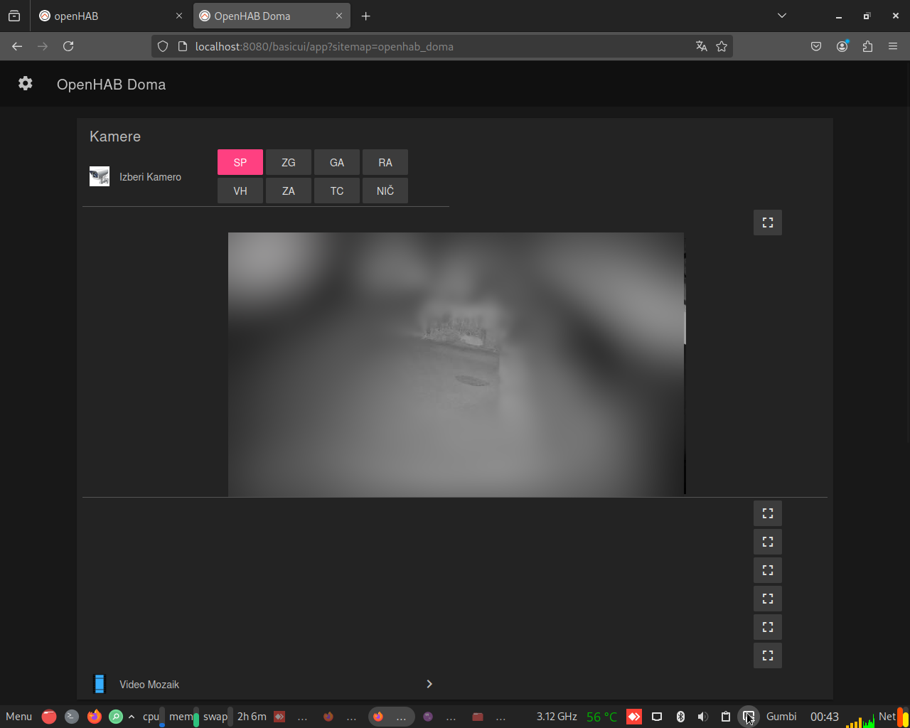

On OH4 there is an bug within visibility setting as the video resize buttons are escaping the condition of visibility. I see bunch of empty items listed on sitemap with only resize buttons.
It actually clutters up the sitemap badly, so the fix is needed.
The OH4 sitemap screenshot

I believe I found the cause just by reading the code, one line code is missing for MJPEG video. I will provide the fix during the next weekend.

https://github.com/openhab/openhab-webui/pull/2764

Fix is now merged and also backported to 4.2.x branch.
So it will be available in patch 4.2.2 that should be released soon.

Looks like the fix is working :smiley:, i am so greatefull, now it looks mint.
I just installed snapshot release as i have new mini PC i am building to replace the old gear.
