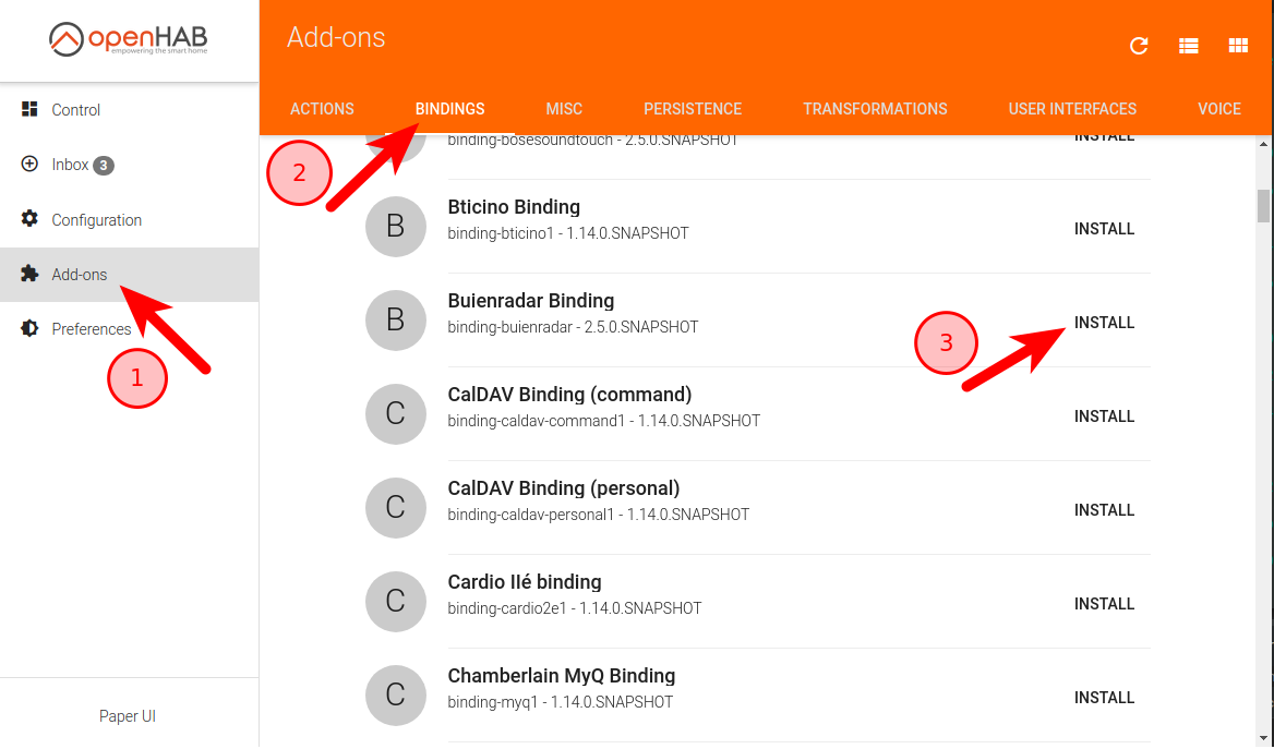

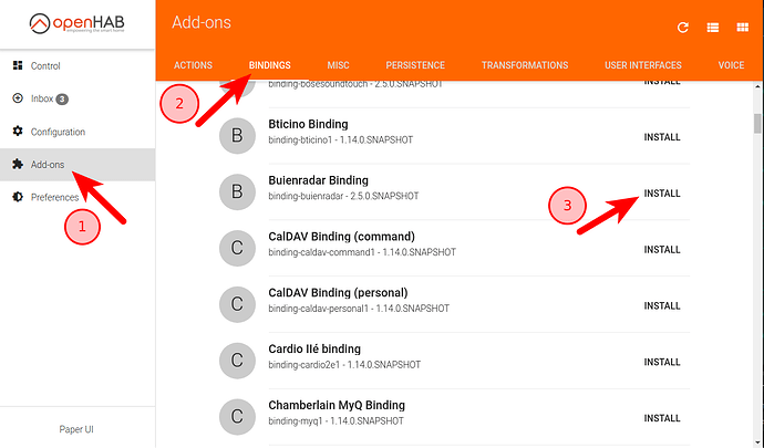

How do I install the binding? I can’t find it in paperui or marketplace. Google won’t let me find the jar file either.
Hey @ljsquare, did you find a solution? I’m facing the same problem.
It’s currently only available in the 2.5.0-SNAPSHOT version (which is used for testing).
You can install it via Paper UI:
thx @wborn that ends my search :wink:
I’m using version 2.5m1 and I’ve extracted the binding from the snapshot addon kar file.
You can also add this org.openhab.binding.buienradar-2.5.0-SNAPSHOT.jar to your addons dir. I gave it a brief test and it seemed to work with the 2.4.0 release. :slight_smile:

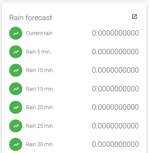

Thank @wborn Plugin is installed, no errors. Seems to work, now waiting for rain to see if it really works. Kind of doubdfull dough. I’ve excpected a 0 for current rainfall but i get a -.
We’ll see in a couple of days i gues :wink:
Hehehe. Nice, i love this binding.
I see correct values for rainfall when I add a location where it will rain on the map: :slight_smile: :umbrella:
