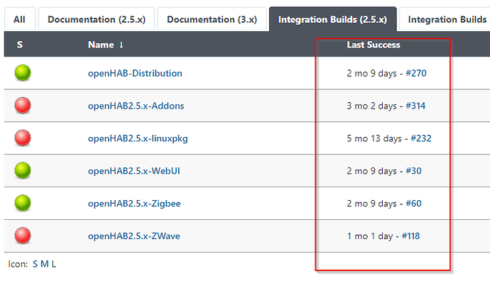

Is 2.5 still being developed? I have not seen snapshots for a month or more.
Latest was 2.5.12, but the SNAPSHOT version was changed to 2.5.13 AFAIK.
If critical bugs are reported, a new bugfix release can be rolled out…
From Jenkins
Yes, no nightly SNAPSHOTS for 2.5.13 actually, but can be build if needed.
