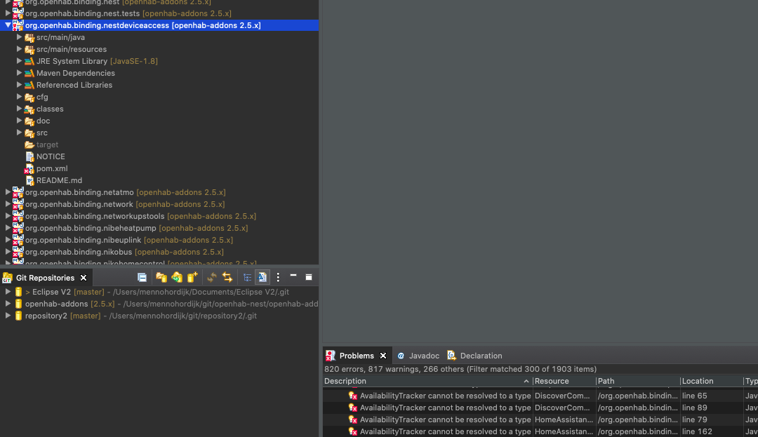

What I’ve done: I have installed Eclipse on my Macbook. Also installed latest version of java. But when I’m importing a total github library and try to export the JAR file, I see a lot of errors (820), like:
AvailabilityTracker cannot be resolved to a type
Before cannot be resolved to a type
ChannelConfigurationTypeAdapterFactory cannot be resolved to a type
Hopefully someone could give me some tips/advice on what to do. I’ve searched the internet for more then a week to find a solution by myself, but I have still nog found it.
