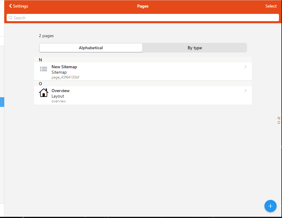

How do you delete a sitemap in pages? I have only a save option in the top right corner.
You should have a select option, when nothing is focussed:
deleteOh3Sitemap
Also Ctrl+click on the list to select, if you have a keyboard.
