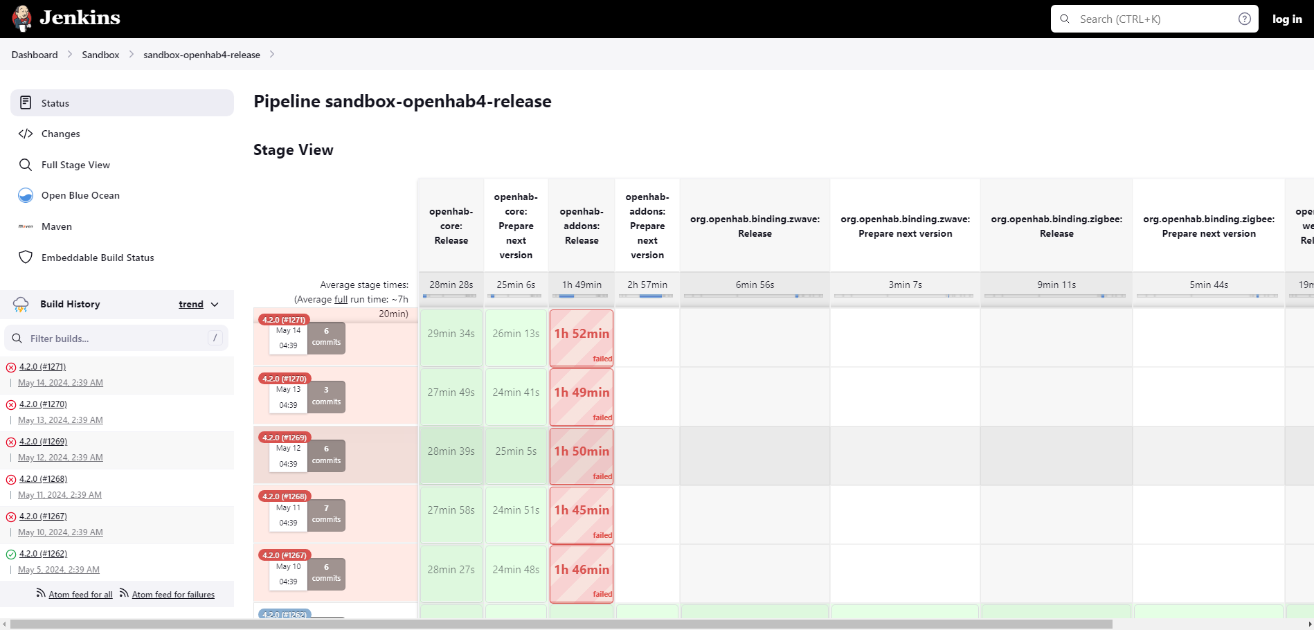

Builds for 4.2.0.SNAPSHOT failing? 4.3.0.SNAPSHOT too

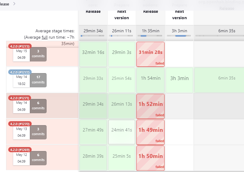

I have monitored the latest fixes going into the 4.2.0.SNAPSHOT builds using the following link:
https://ci.openhab.org/view/Sandbox/job/sandbox-openhab4-release/
For the last week or more the builds seem to be failing and I have not seen any comment on the community - so maybe I am looking at the wrong thing?
The options available seem to be:
Mark
Thanks for reporting. Indeed the builds have been broken since May 5th:
https://github.com/openhab/openhab-addons/pull/16762

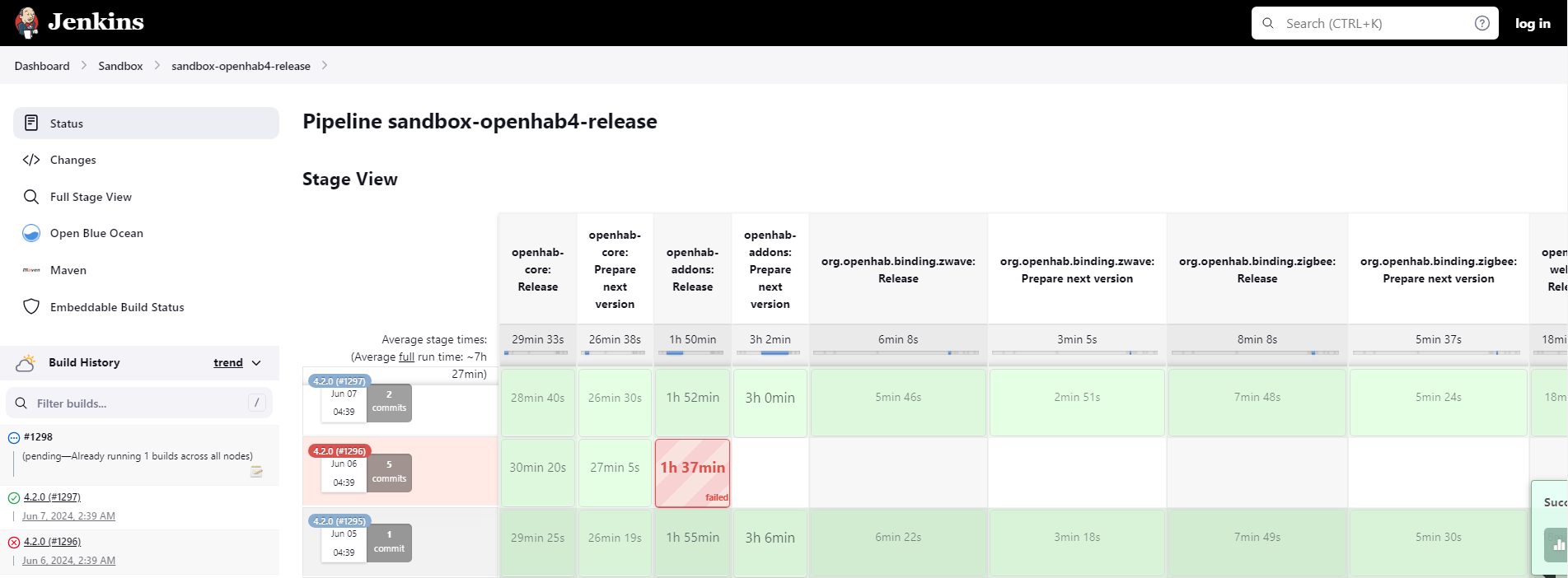

Thank you. The build seems to have worked once and then failed again this morning?
That seems to be caused by network issues, so hopefully it will work tomorrow:
[ERROR] Failed to execute goal on project org.openhab.binding.boschshc: Could not resolve dependencies for project org.openhab.addons.bundles:org.openhab.binding.boschshc:jar:4.2.0: The following artifacts could not be resolved: org.bouncycastle:bcprov-jdk15on:jar:1.70 (absent): Could not transfer artifact org.bouncycastle:bcprov-jdk15on:jar:1.70 from/to central (https://repo1.maven.org/maven2): Connection reset -> [Help 1]
I triggered it again so we can already see how this cliff hanger will end tomorrow. :popcorn:

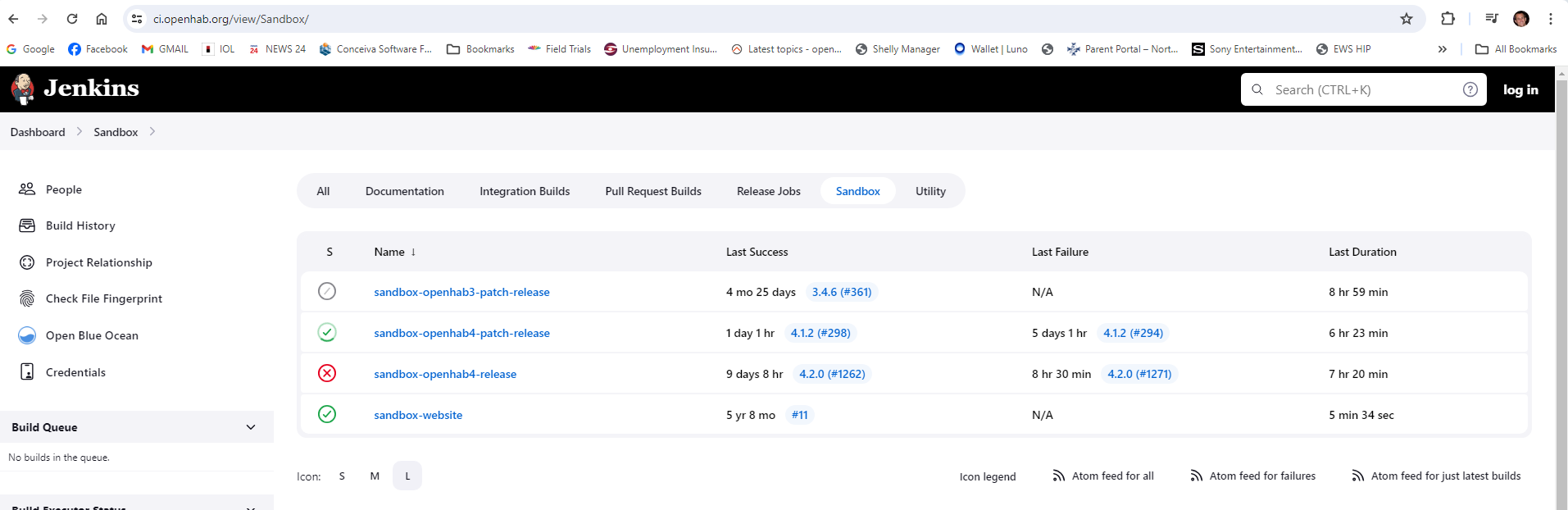

Hi Everyone
There seems to be a problem here again:
There seem to be no new builds sine 7 June?
Mark
Builds got blocked by sandbox-openhab4-patch-release which got stuck for days. I cancelled that build. Let’s see how well it works now.
Thank you. Has failed again
Could you check?

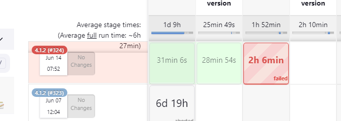

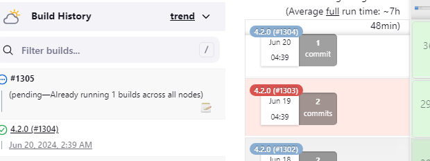

Hi All
Looks like there is a problem again? Last build was 20 June?
@wborn - this got stuck again:
Can you cancel it?
Just did that! We should add a timeout to the pipeline so it aborts automatically whenever it gets stuck.

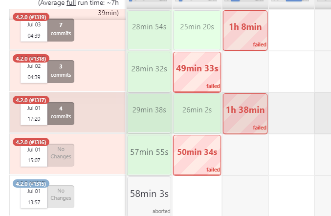

Hi All
Sorry to report that builds are failing again:
Yes I already noticed that too and tried to fix it with some build parameters tweaks but it didn’t help so far. Maybe upgrading the ~10 year old maven-deploy-plugin helps (openhab-core#4295, openhab-addons#16987). If you have more ideas on how to fix it let me know. :slight_smile:

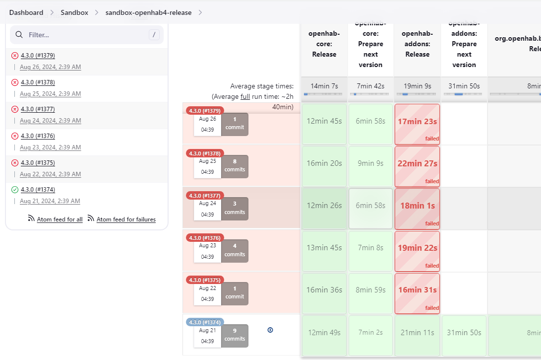

Hi All
Looks like builds are failing again:
