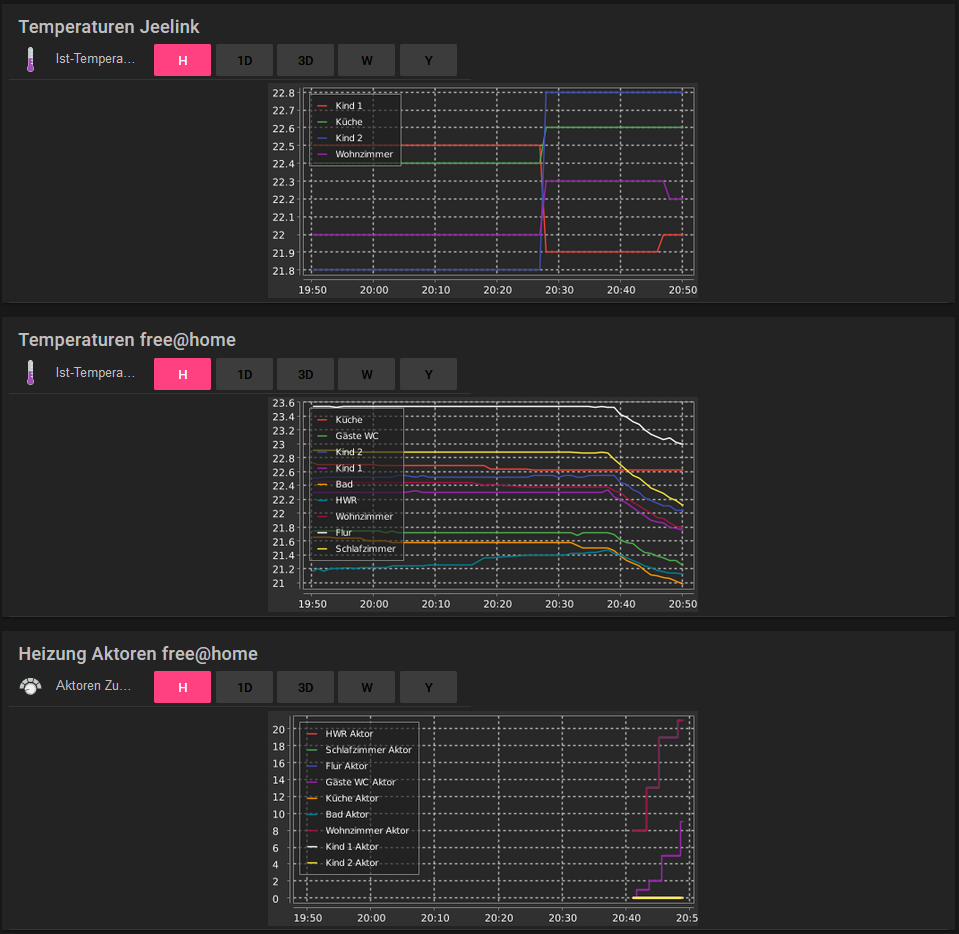

To take the last point first: Just created a new version to implement heating state / actuator state. Please feel free to test and report any errors/misbehaviour.
  • odp0011: Retrieve heating state (set up as on/off switch, read only)
  • odp0013: Retrieve heating actuator state (set up as a dimmer (0-100), read only)

Last plot in list shows the new heating actor status. Nice!
Thanks.
